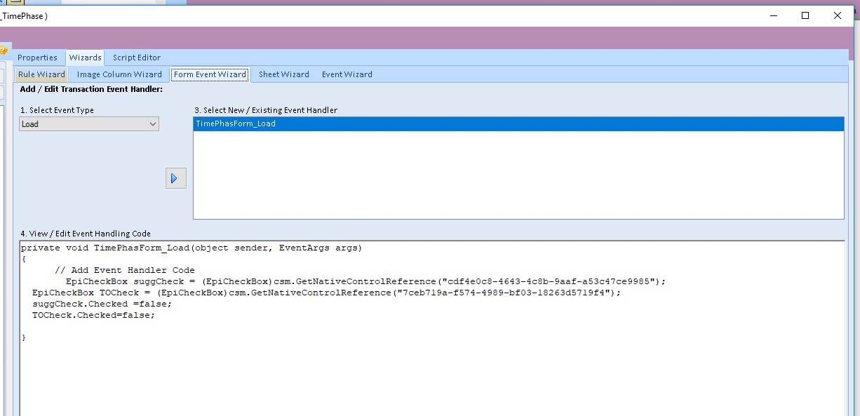

I did it in E9. I customized the view and used this in E9. Maybe this will help you.
private void TimePhasForm_Load(object sender, EventArgs args)
// Add Event Handler Code
EpiCheckBox suggCheck = (EpiCheckBox)csm.GetNativeControlReference(“cdf4e0c8-4643-4c8b-9aaf-a53c47ce9985”);
EpiCheckBox TOCheck = (EpiCheckBox)csm.GetNativeControlReference(“7ceb719a-f574-4989-bf03-18263d5719f4”);
suggCheck.Checked =false;
TOCheck.Checked=false;
