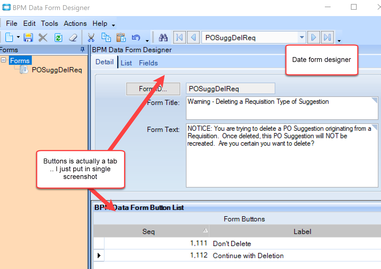

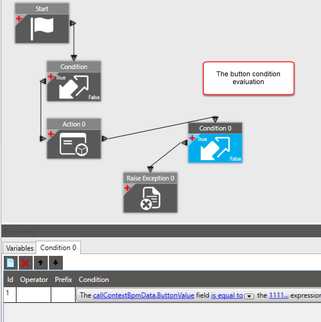

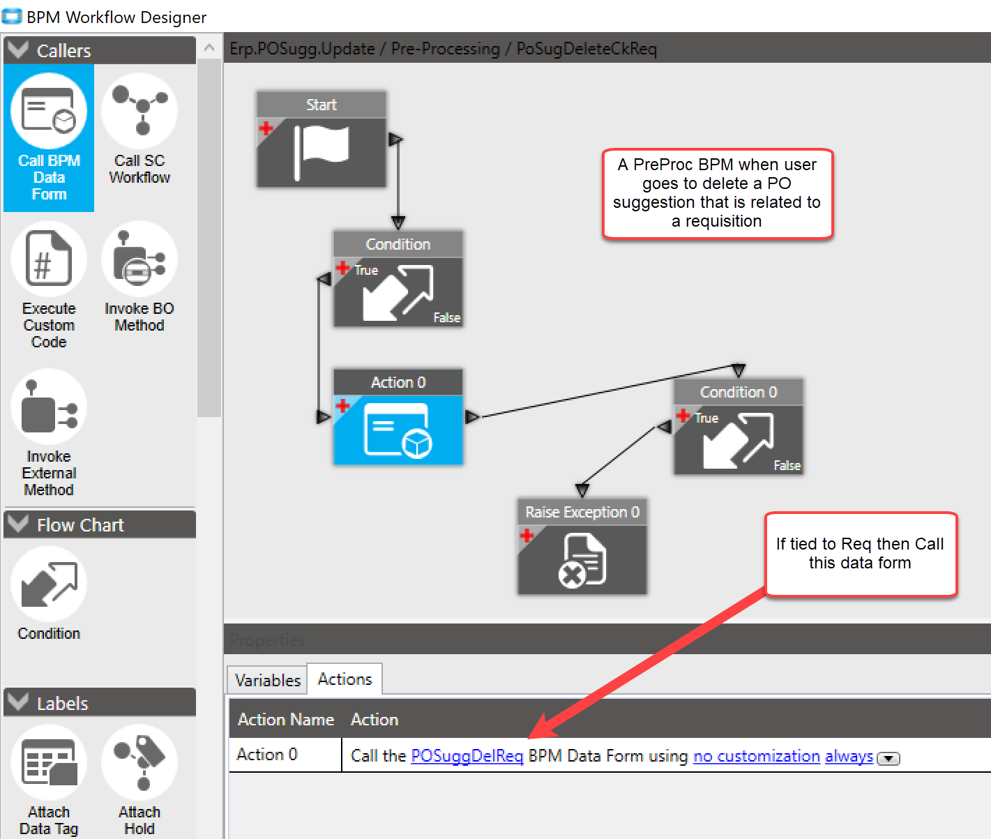

Hi Dylan,
Here are some screenshots to help get you moving:
Nancy
That seemed to do the trick. Next question I have is how do I get call context passed over to the form?
