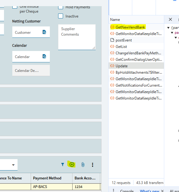

Not sure exactly what you have in place, what does the trace show when a new one is created? That’s the golden ticket to BPMs. Sometimes we’re just trying to trigger them on the wrong method.
Thank you.
If I click on the plus sign to add it shows as GetNewVendBank
When I enter the details and click Save, it shows as Update.
