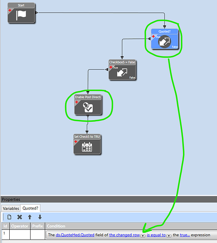

Here’s my example, using Quotes. (I’m also doing a secondary condition on a another Checkbox which I toggle to TRUE at the end of this directive. If that checkbox is false, it’ll enable the post directive and then set that checkbox to true. That way, the next time this same quote runs through this directive, the checkbox will be TRUE and it won’t send the email again. I don’t want to get an email every time someone toggles the quoted checkbox. Just the first time.) So, for your purposes, you can ignore those extra widgets.

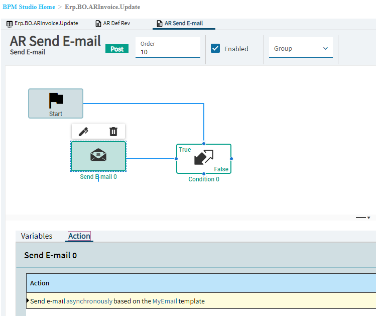

Here is my POST directive:

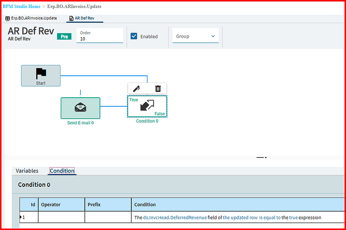

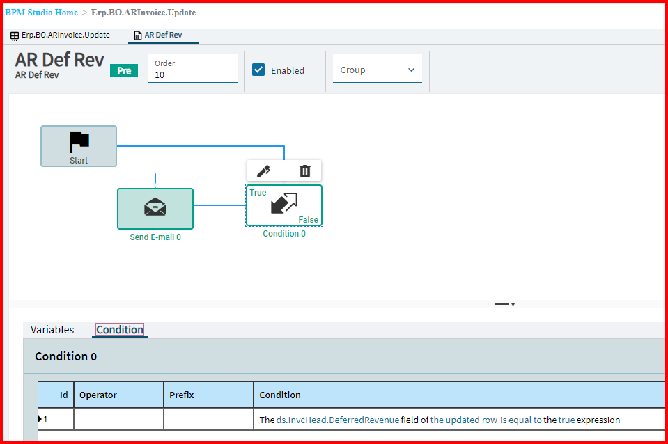

I’m still struggling to get this to work. My Pre directive is

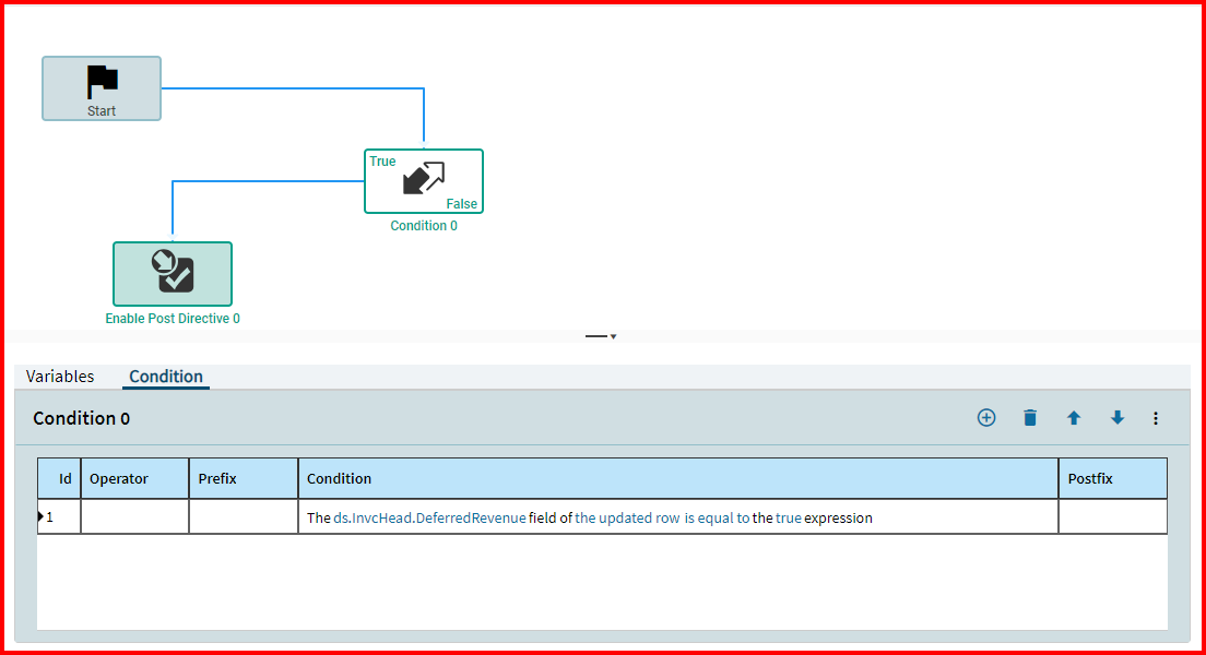

My post directive is

I don’t know if this will fix your issue with the email not being sent, but the condition you’re using in your Condition Widget is not the correct one for the condition described above. You currently have “The DeferredRevenue Field of the Update Row is equal to true”. This would fire the email every time the InvcHead record is updated, regardless of what field is updated, as long as that field is true. There is a different condition option “The <Specified Field> has been changed from <Value> to <Value>” or in your case, “The Deferred Revenue Field has been changed from false to true”

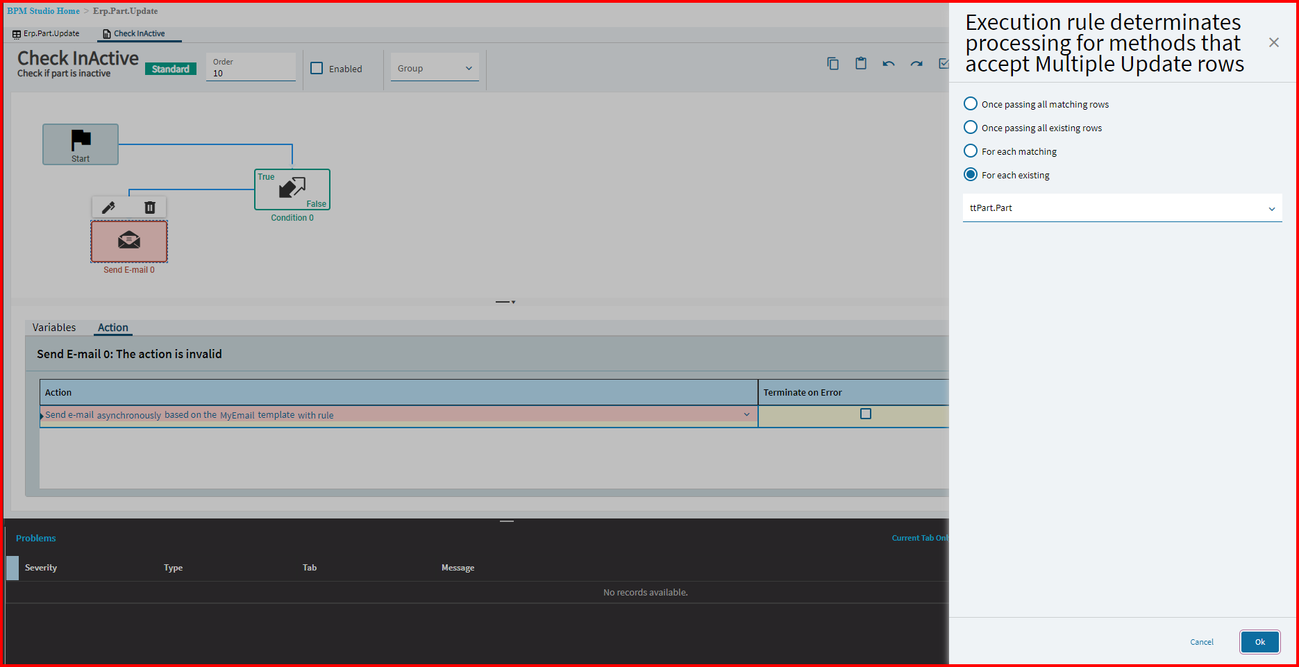

I do not have a lot of experience as you may tell. I created a data directive as below but getting an error probably around the rule or maybe something else.
