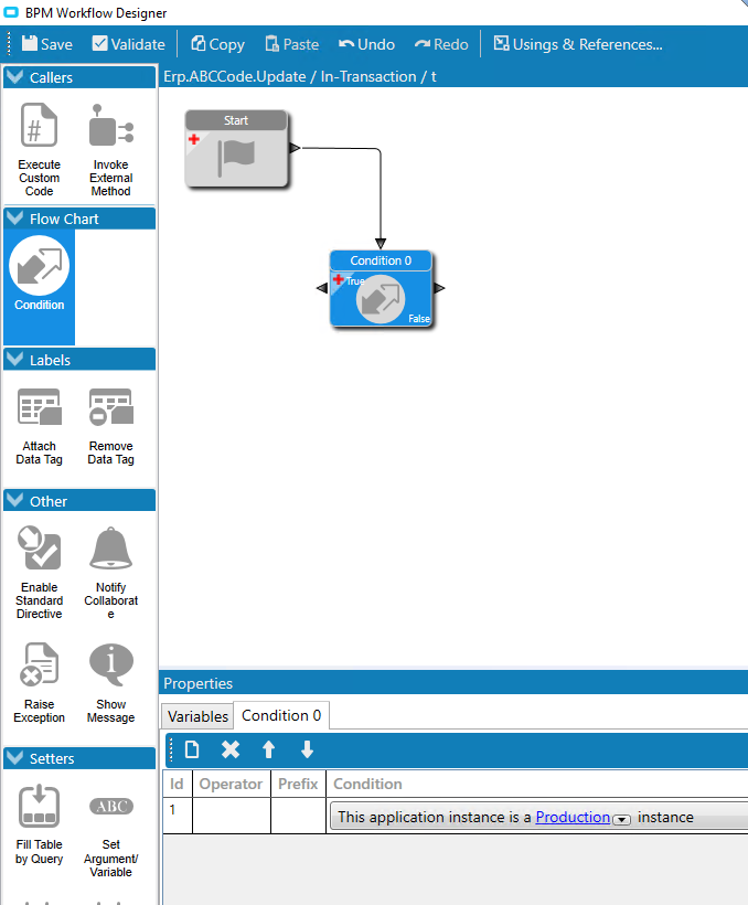

BPM Workflow Designed Condition "This application instance is a production instance" not evaluating as expected in Epicor Cloud
We created several data directive workflows that we want to include the “This application instance is a production instance” condition statement, which does not evaluate as expected in a cloud environment. We want to record changelogs and send out email notifications only from our production environment without having to disable BPMs on our pilot or third database during a refresh.
I would like to be able to accomplish this by inserting a condition into the workflow however “This application instance is a production instance” does not evaluate as expected in the cloud environment.

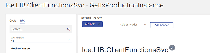

Are you familiar with the REST services? You can check the setting using this endpoint:
Not saying this is what you should do, but if you need to, you can.
You just have to work around it by either calling via rest, or another bpm, ubaq, whatever.

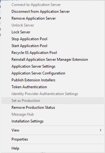

I believe the “This application instance is a Non-Production/Production instance” condition is not related to the checkbox you see in Company Maintenance.
Instead the “Set as Production” option should be set in the Epicor Administration Console in the appserver settings.
You can request the Epicor Cloud team to do this for you.

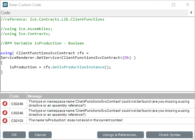

I have attempted to input this exactly on my in-trans BPM here is what I get:
You’ll have to add that assembly in the references.
And that BPM Variable was a variable set in the widgets.
