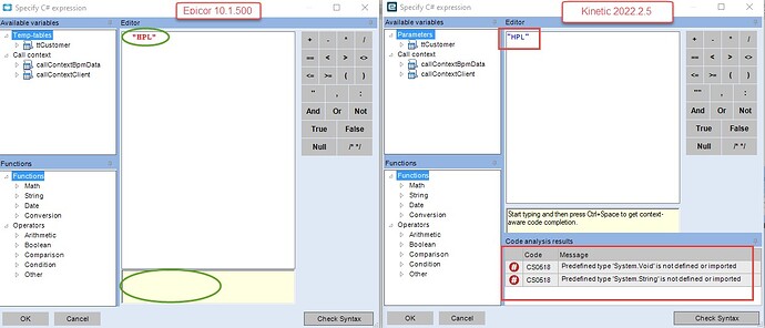

When looking at the build, it appears that it does not like the company identifier HPL in this case.
I have tries using double quotes “HPL”, single quotes ‘HPL’, double double quotes “”HPL””, double single quotes ‘ ’HPL’ ’ and no quotes around the company Id, but still get syntax errors.
Can anyone please advise how to fix this error (see screen shot for more info).

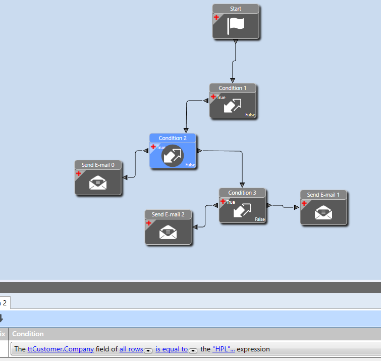

We have three companies set up within our database, the company identifyers being HPL, PCL and HPR. The code is from a BPM ‘condition’ element, if the result is for one company, send an email to one person, the other comany, a different person.
For some reason, on my workstation, it would not accept the syntax “HPL”.
However, when making the changes direclty on our Kinetic server, this works!
So, as a work around, I am now doing any BPM design on the Kinetic server.
FYI, I have attached an image of where the ‘condition’ is nested.
