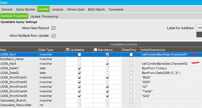

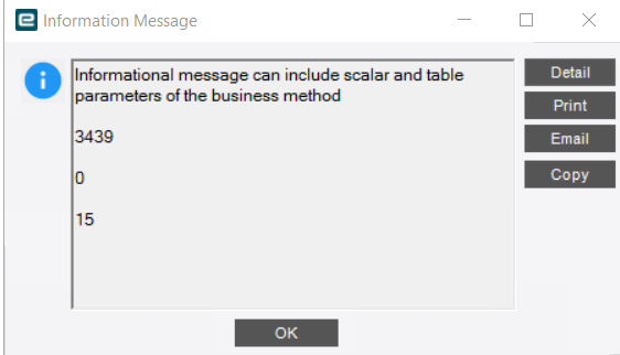

I have a UBAQ and I want the initial values to be driven by the main record the user has selected. I adjusted the BAQ to have a parameter and then I adjusted the code for GetList to store the parameter value into bpmContext Character01 using a post-processing BPM. This is the popup box when that runs showing Character01 (3439) and others in my testing.
I set the initial values in the proper place in the BAQ:
After I click on the GetNew button, the values in the record are missing Key1 and Key5
I have put in info messages and the bpmcontext is blank in the GetNew BPM.
