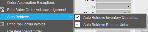

Also sometimes depending on the UI the User has a certain Auto-Retrieve flag turned off.

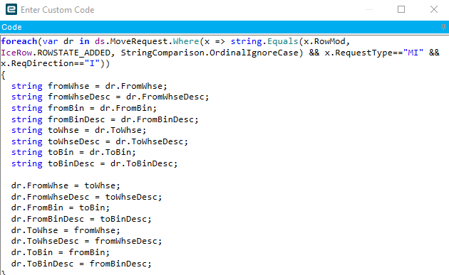

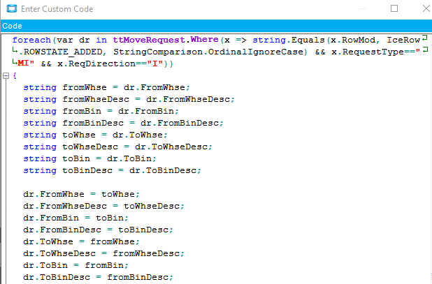

This BPM is populating data in the Move Inventory Request screen. Here are some examples:
New BPM:
Old Custom Code:

New Custom Code:
image (19)
@mc9306 I am with @hkeric.wci that you will have to look at the trace of the manual process to see what is different now. The code looks like it could have already been converted up from 9.05, but it is the same code as before just not getting the same changes made.
