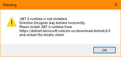

I know that .net is being tossed in favor of more robust services. But I figured that Epicor would do some work to make the transition easier. Today, I am trying to look at a BPM in Pilot, and I get this error:
After I click OK the BPM designer shows up with another error, and no widgets.
Did the “upgrade” disable the BPM editor? I assume this error message is not what Epicor wants you to do. Anyone else see this?

Does Kinetic use .NET Core now? It was .NET Standard 4.8. This is new.
We faced the same and we install it as suggested on the local machine and restarted the local PC, Issue will get resolved.
That’s interesting because I’m running 2022.1 on my machine without .NET 6.0 Runtime installed on my client with no issues.
That explains why it works for me, we’re still on 2021.2.13 in our Pilot environment.
Server is using .NET6
Client still using .NET Framework 4.8. But BPM is special - it needs .NET 6 on client for editor to work. this is what the message suggests you to do - install .NET6 on your machine
'cuz you’re special @hmwillett
@Olga thanks for the clarification and I’ll make sure we install it when we upgrade our Kinetic.
It is interesting that the BPM runs just fine. My dashboard that utilizes a UBAQ and BPM to update records on a UD table works just fine. I just can’t actually look at the BPM. Still waiting on the official reply from support. But from the sounds of it we will need to install this file just on my machine.
BPM runs on server, so its execution should work as before.
I can confirm Epicor support directed me to install the software on my client and check back if I have issues.
Since BPM works with code that will eventually be compiled for the server, it works better with the .NET 6 SDK installed on the client so that it can do a better job of validating the code. The message is letting you know this although it may be more scary than necessary. We’ll look at rewording it.
If the .NET 6 SDK is not installed on the client, the BPM designer will gracefully fall back to using .NET Framework 4.8 after giving the warning.
To reiterate what was posted above, the server runs on .NET 6 and the (non-web) client remains on .NET Framework 4.8.
The issue reported above with the empty designer is likely unrelated and should be reported to support.
