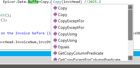

In the process of doing an upgrade from 2023.2.22 to 2025.2.14, and needing some detail around the difference of BufferCopy.Clone Vs BufferCopy.Copy in an Epicor Function.
After performing an upgrade conversion I have errors stating that ‘BufferCopy’ does not contain a definition for ‘Clone’ When I look at the intellisense I see
I don’t really understand why there is duplication there. That’s the first thing. The next thing I really wanted to ask for people who are much more skilled than myself, is there a difference and if so could you explain?
Thanks.
The intellisense is just not complete, those are different signatures for the same thing basically.
