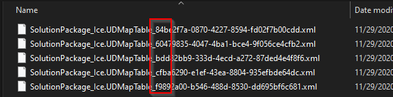

The .cab itself will build the manifest and files in the following order:
Notice how BDD is now in position 3
The UDMapTable has an auto-increment key MapTableID so if you install this cab it will use the file name as the order to install:
  1. 84be2f7a-…
  2. 60479835-…
  3. bdd82bb9-…
What happens is that upon install the auto-increment key will make 84be2f7a 1 and 60479835- 2 and bdd82bb9 which carries MapTableID 1 in the xml will ask if you want to overwrite since the auto-increment gave someone else 1

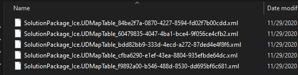

The 2nd screenshot shows them listed in alphabetical order:

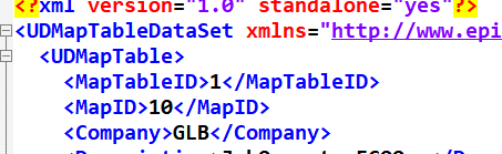

While your 3rd screenshot ( and the apparent order they were processed in) was ordered by neither MapTableID nor SysRowID
Why is Table _84be... being processed first? It’s not first alphabetically, nor listed first in the CAB. Does it have the oldest file date?

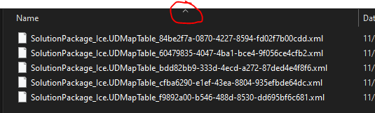

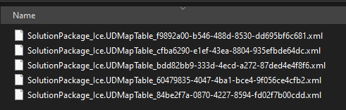

Not sure apparently it is :slight_smile: if I sort even in explorer by file name.
I created replicas with text file same sort.
https://www.askvg.com/how-to-disable-numerical-file-name-sorting-and-enable-classic-literal-sorting-in-windows-xp-vista-and-7-explorer/
Ohhh … so the files are sorted taking the numeric part first and makes them a “number”, such that 84 comes before 60479835. But regardless of this, _bdd8...need to be processed before either of those two.
