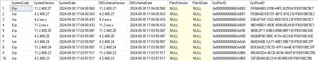

I checked the Ice.ICEVer table and found the following:
You’ll notice that where 4.2.400.26 should be instead just had 4.2.xxx.x and the same for 11.2.xxx.x. As it was just a pilot environment I fixed these 2 references up using sql and then was able to add the database back in and perform data model regen successfully. Case raised with support. I guess it will affect anybody applying .26 or .27 update, and potentially the next one if the script fix doesn’t make the cut for .28.
