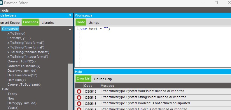

I don’t suppose you would know why I am getting these errors? Brand new library, brand new function, installed .Net 6 SDK…
Maybe some help in this thread? Seems like some people were able to fix it, others not… no true solution marked in the thread.
Yeah. I saw that thread. I have done all of those steps. I guess I’m just in the group that is S.O.L. Thank you for your response though!
