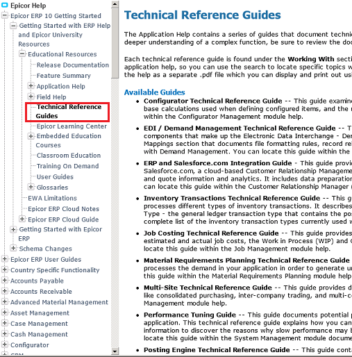

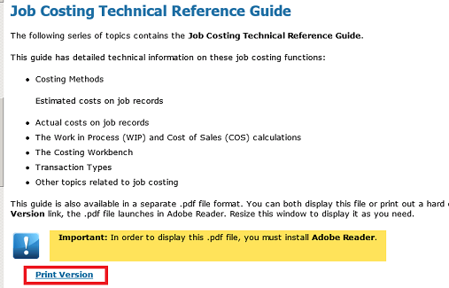

Have you already checked out the Job Costing Tech Ref Guide?
If not, you can find a link to the PDF in the E10 Help.
I think it will provide more details and examples than the basic help will.
There are also links in the help to a few other Tech Ref Guides…

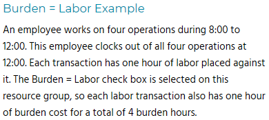

I do think this is what we want (from the help screen for Job Management):
