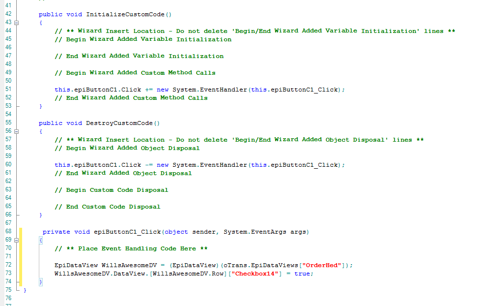

	private void epiButtonC1_Click(object sender, System.EventArgs args)
	EpiDataView WillsAwesomeDV = (EpidataView)(oTrans.EpidataViews["OrderHed"]);
    WillsAwesomeDV.dataView.[WillsAwesomeDV.Row]["Checkbox14"] = true;
        EpiDataView WillsAwesomeDV = (EpiDataView)(oTrans.EpiDataViews["OrderHed"]);
casing issue
And you better be just doing this for a test, and redoing all of this later with NAMES ON YOUR CONTROLS!
If you leave your button as “epiButtonC1” then…
I don’t see it. :sweat_smile: :person_shrugging: :person_shrugging: :sweat_smile:
Capital D in EpiDataViews
I’m assuming that is line 73. I asked for a screen shot, because then I could see which line it’s complaining about.
I was going cross eyed. LOL! Changed it, still same error.
ah, the . after dataView doesn’t belong there.
WillsAwesomeDV.dataView[WillsAwesomeDV.Row]["Checkbox14"] = true;
That compiled!
