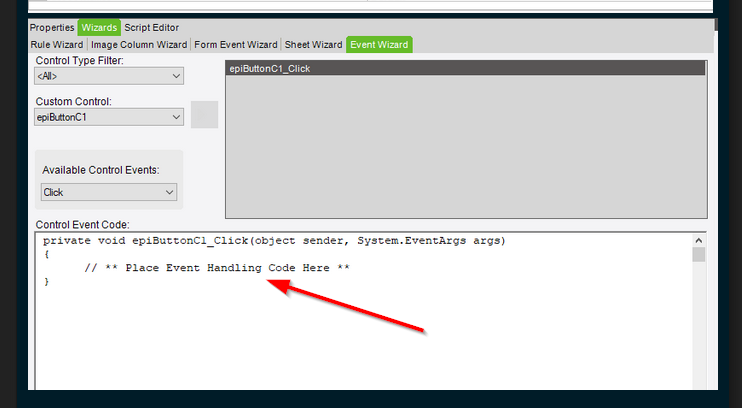

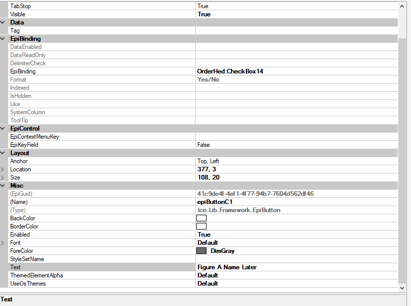

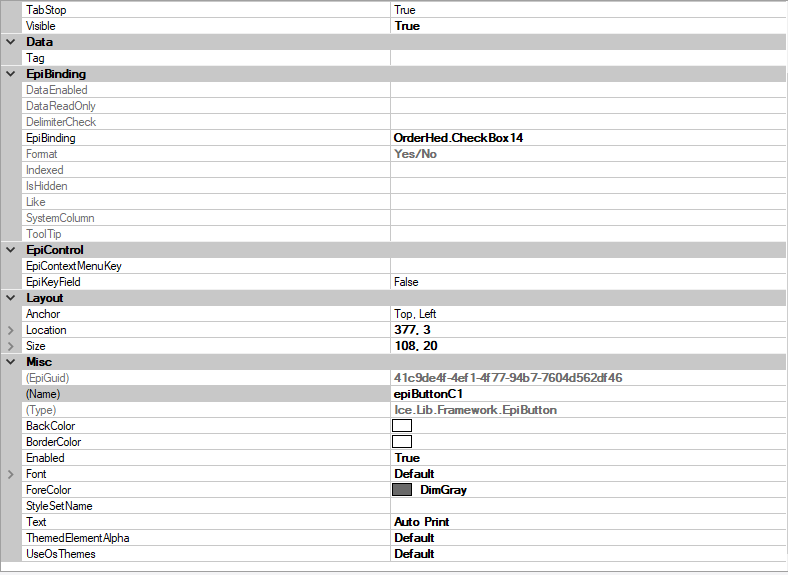

Here’s screenshots of what I have done so far:
Yup that’s the way to get the button to click. Please (for the love of God) rename the button first though.

I didn’t pay attention to the binding. Binding the button to a check box won’t do anything except for make the button read only if the field is read only. (for example if the record isn’t loaded yet). So that’s helpful, but it doesn’t actually add any functionality for you.
So you’ll have to code what you want the button to do on the button click.

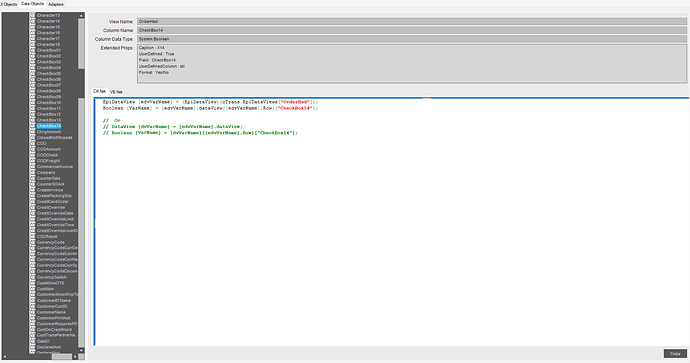

So, I found the dat views, and found the checkbox I was looking for. I’m assuming this is where I put the code to check it upon the click?
Note: I just picked this checkbox to use, the final one will be a new checkbox properly named.
Correct. in the Method epiButton_Click(), you set the dataview field to true.

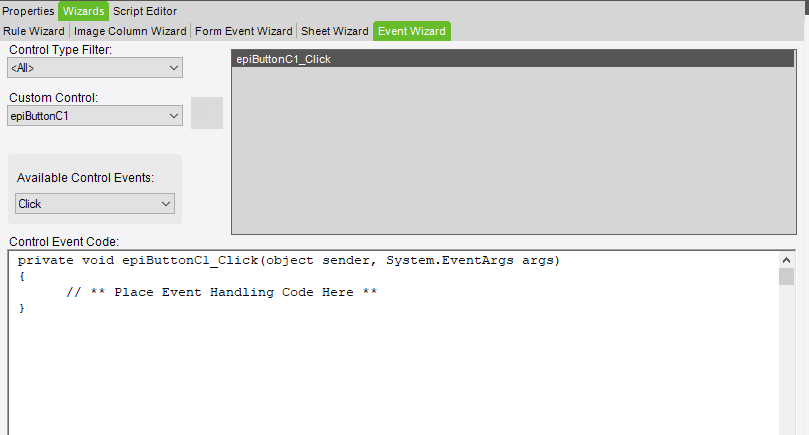

I do not see a method listed here. Do I add it in? Or am I in the wrong place?
You already have the method. That was in your wizard that you showed earlier. This is how you get ahold of the data view. (that’s the first line). And the second line is how you would get what the field is.
In your case since you are trying to set it, you flip that.
EpiDataView WillsAwesomeDV = (EpidataView)(oTrans.EpidataViews["OrderHed"]);
WillsAwesomeDV.dataView[[WillsAwesomeDV].Row["Checkbox14"] = true;
So you assign the dataview to whatever you want to call it. Then in the dataview you set the value.
This goes in the method that was created with the wizard from the screen shot you posted.
See if that compiles.
Edit: it goes here. (In the script editor tab)
