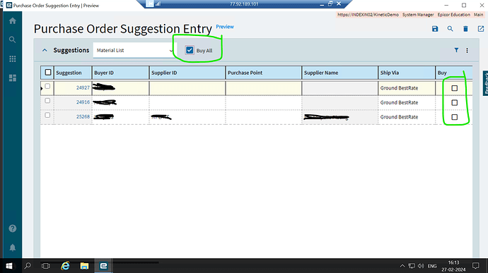

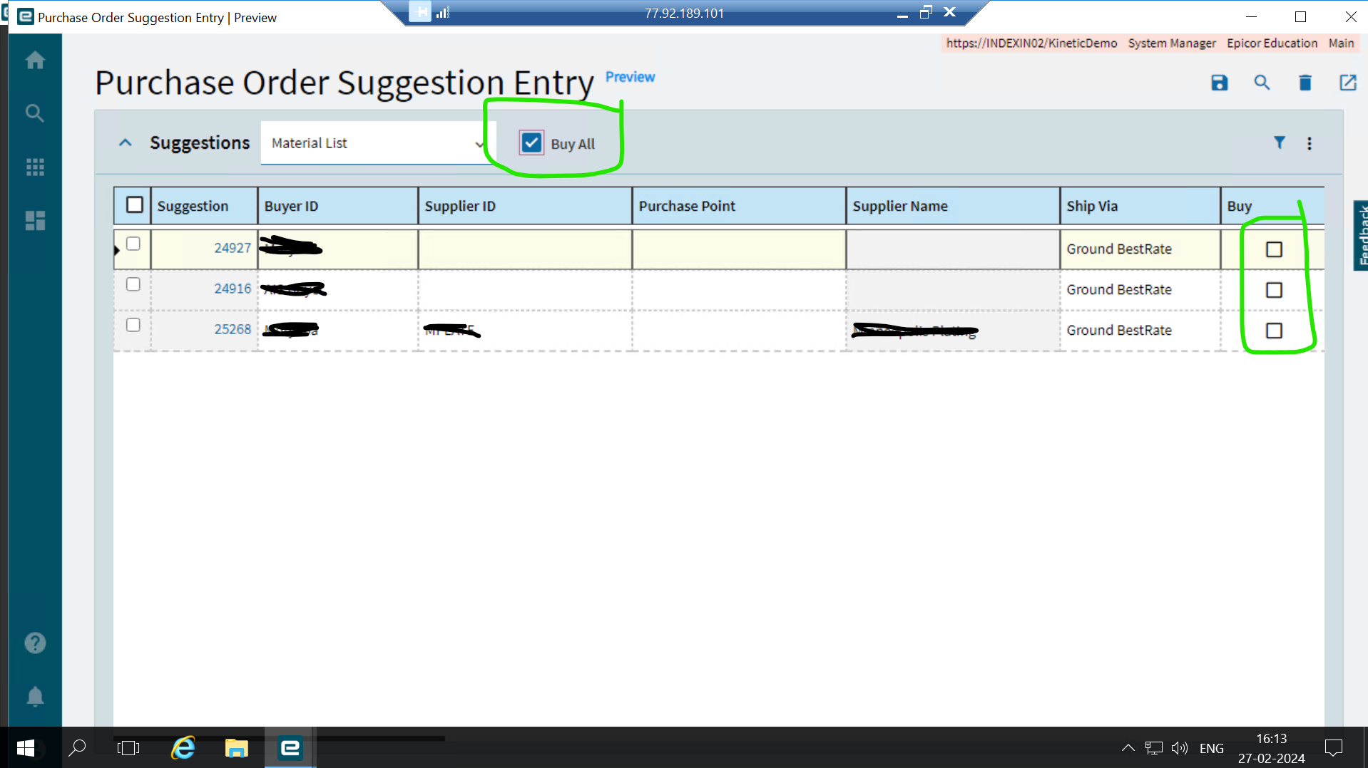

Hi , I am trying to add a checkbox on the landing page of the NEW PO Suggestion this should be like Buy All when the user changes the checkbox to true it should select the buy checkbox in all records
is there any suggestion ?

yeah i did this but auto select not reflecting … is there any method using bpm or datarules or events to update all rows in landing page ?
@Eslam_Mohamed Unfortunately the grid is progressively loaded and therefore the select all capabilities will not be available.
Is that not why this button was added??
@aosemwengie1 That will toggle the grid into a non progressively loaded, however the selector control cannot toggle between the two modes currently.
