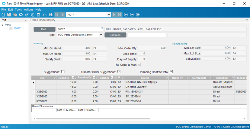

I thought this because Time Phase says so:
My test (same results)
I set up two BTO releases on the sales order and two corresponding PO lines. I did one receipt and it added 5 to on-hand (was 8; now 13).
But the accompanying sales order is not taking away the 5 in Time Phase. It just goes from 13 OH to 13 OH. Similarly, the other, future PO line is showing as not hitting OH either.

The only thing it does it mess up Time Phase Inquiry
Yup. I put in a ticket.
I know in previous versions this worked exactly as you described, I just checked with a 10.0 client and it works as we would expect.
I wonder if the way cross docking works has changed and there is now a configuration of some sort.
Well that is reassuring, oddly enough. I’m not crazy to want BTO to work.
