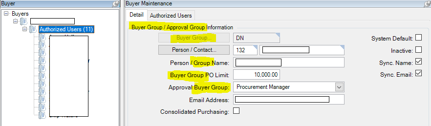

  • A “Buyer” in Epicor is actually a group of users. It is generally not just one person. I’m calling them “Buyer Groups” in this guide.
  • Normally you want more than one person in each group, so that if one person is out, someone else has access to work on the PO.
  • If you want to securely use the PO approval amount process, you need to be very careful on who you put in each group, and what PO limits you place on each group. Otherwise someone could use someone else’s group to place a PO for a larger amount than they are authorized. Also know that a $0 limit means no limit.

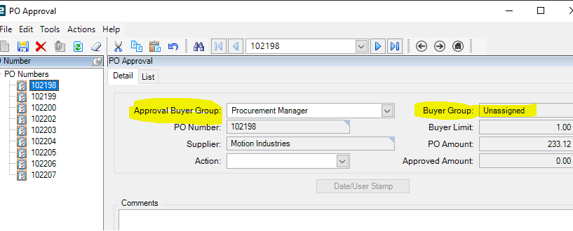

  • Approval permission is assigned to a Buyer Group, NOT a person! So anyone in that group can approve POs for a lower group.
  • You can have as many levels of authorization as you want. So the PO can be made to go through several successive people before being authorized.

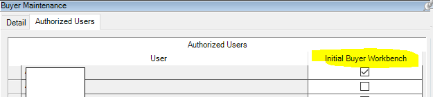

  • In order to access Buyer Workbench, (currently) a user must have the Primary Buyer checkbox checked on one of the Buyer Groups s/he is part of.

  1. Make a Buyer Group called “Unassigned” with a PO limit of $1. Add all purchasing agent userid’s as authorized users to this group. Set this as the System default group.
  2. Create individual buyer groups for each agent, with a suitable PO Limit amount for each user. Check the Default/Primary option for each user’s matching group.
  3. Not everyone needs their own group! If IT or Management want to be able to see suggestions etc, add them as authorized users on the Unassigned Buyer group. Check the Detault/Primary box for them on this group.
  4. Add at least one peer or supervisor to each user’s buyer group. So that if the user is out, someone else can edit their POs. Be careful not to add a junior agent (with eg a $1k limit) to a senior agent (with eg a 10k limit), or the junior agent would be able to place 10k POs under the senior buyer group, without approval.
  5. It may be best that senior agents have low PO limits on their personal buyer group. Then they can include the junior agents in their group, without above risk.
  6. Make a Management buyer group with a higher limit (with eg 100k limit), and add senior users to it. They can then authorize their own POs, without giving their limit to junior agents.
  7. If additional approval is required, create an Executive buyer group, assign as Approver to the Management group. Can have no limit ($0), or can add a limit and have more levels as needed.
