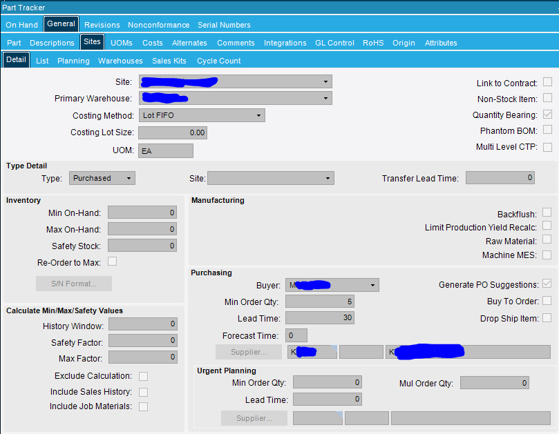

the part that is currently not showing up in the Buyer Workbench has demand in the Time Phase, on the Site tab it has a minimum order quantity, a buyer, a lead time, a supplier, and the box for Generating PO suggestion is ticked. There are no POs open or waiting to be received. The demand comes only from unfirmed jobs.

You might want to provide screenshot of your part detail and part plant and timephase on the part for all sites, to help troubleshoot here in EpiUsers. I find a picture goes a long way to describing the situation.

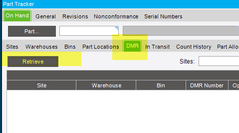

just to cover all the bases, did you check DMR too?

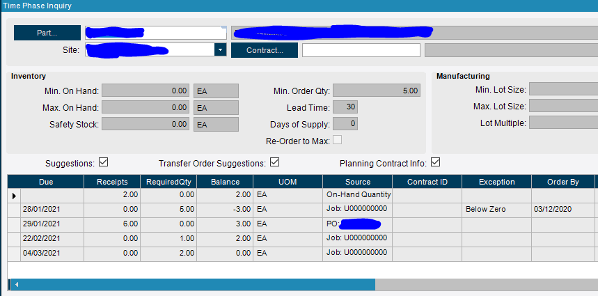

Can you do a screenshot of timephase inquiry too on it?

Empty, we literally have 2 parts in total.
The PO is the new one added today after the discovery of the demand. This morning it was showing all 3 jobs as below zero, yet there was nothing on the Buyer Workbench.

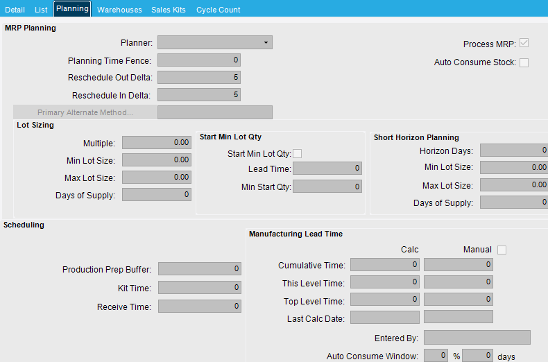

What about the Reschedule Deltas and Process MRP?
Also, do you have like a crazy-long lead time on the supplier price list for the part? I see the first job is supposed to be “ordered” like 9 months ago…
We are using 5 which is no expedite? Would this prevent new suggestions? I thought it would have only stopped changes on already created jobs/POs

I see, we are using the European dates, it is to be ordered by December the 3rd

I’m never certain with those myself. I had played with those settings years ago, but I just ended up more confused than when I started.
Those values control change suggestions.

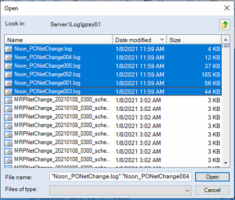

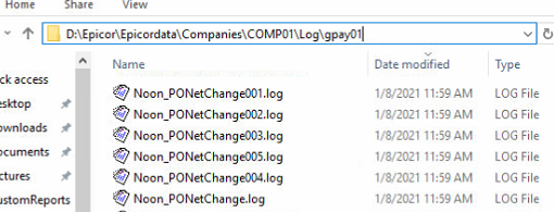

@Valentina You can run a single part on a net change and look at the log on the server to see what Epicor is calculating. If you want to see a full regen you can’t do a single part.
the log looks like this
Greg

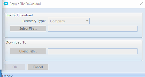

On the server
From Epicor Client use Server file download
Pick Company and then select file. Then Logs and the user id that ran the process. Select a location to download them and click ok.

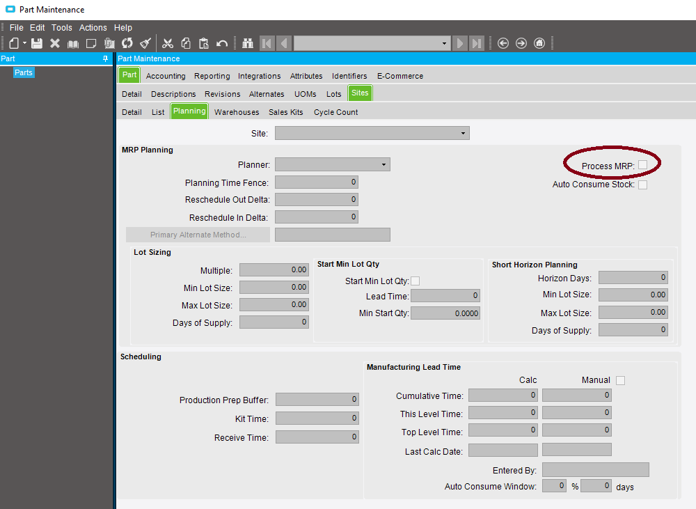

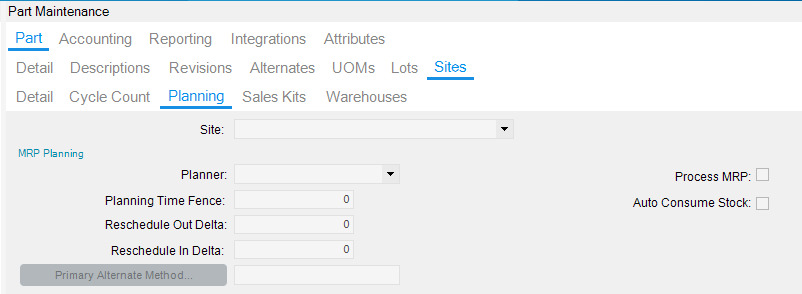

On the Sites/Planning tab, is the Process MRP checkbox checked?
Yes it is
