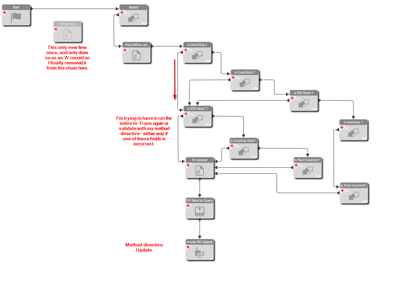

When I run it the first pass through it will do
In-Trans A, In-Trans U, Standard A, Method Update.
What I would like is for it to carry on to run through the In-Trans or DD again, so it can flag the dropship.
Right now, because I have a method directive on Update to validate the fields again, the condition ignore step is a non-issue for me, but still buggy and would like it to respect it. But I need to get further calls to go through to set the drop-ship flag and plant properly. My method directive actually attempts to set BTO, Drop Ship, Plant, etc but because BTO is “not flagged” yet to the system it doesn’t flag drop ship. Once it saves and if I change a random value on the screen, the method directive works fine for swapping those. Just need to bridge the gap between flagging BTO and flagging Dropship.

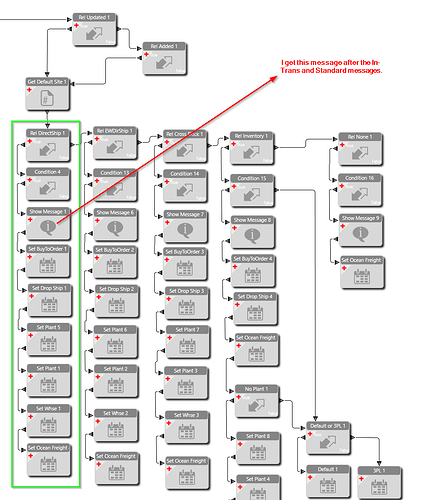

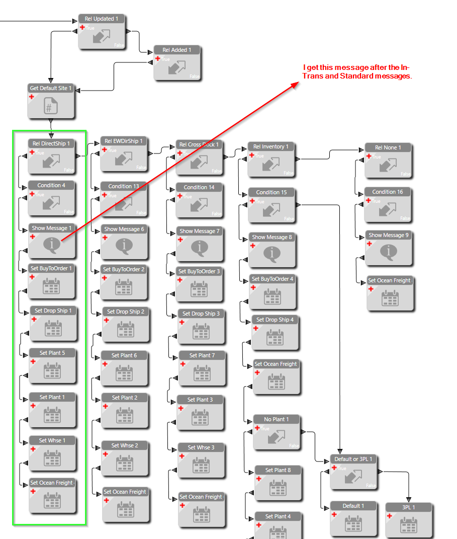

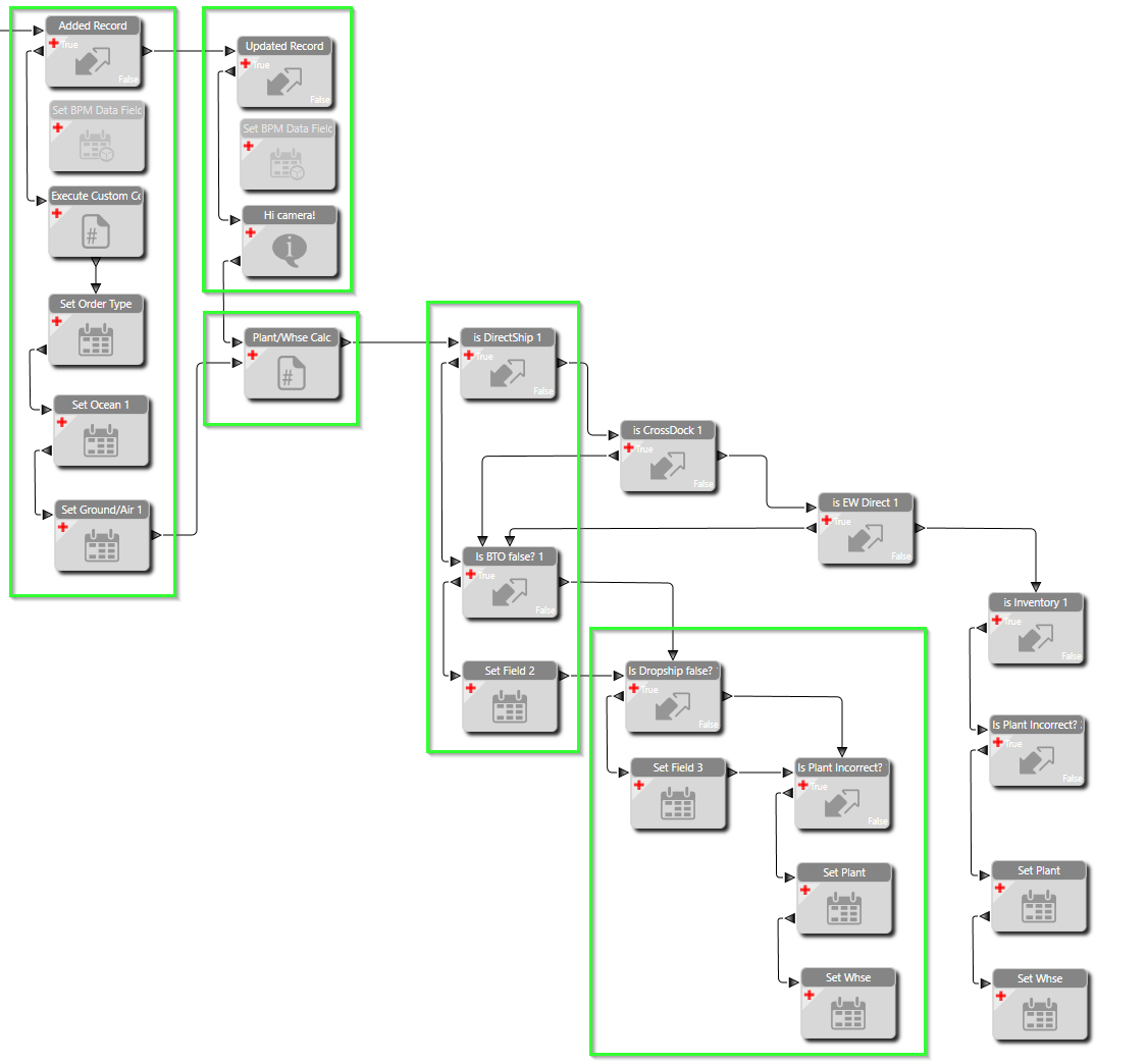

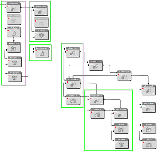

Screenshots of what I’m trying to accomplish
In-Trans
Standard
I tested after this screenshot, but it is making it to the is Dropship false condition
Then it triggers my MD for Update
