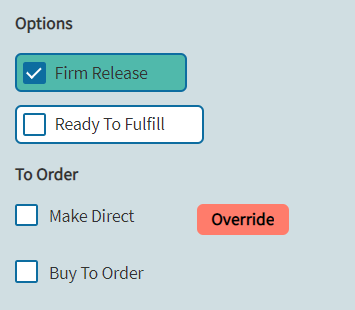

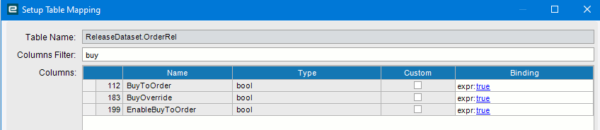

I then tried data directive, which got me close but there is some buggyness with it.

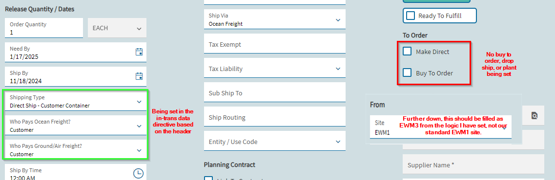

With no BPM

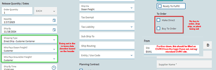

With BPM
It is clearly attempting to do something with it. I tried including setting Make Direct to false and Buy to Order to true but the same result occurs.

Data Directive sees it being added but when I flag the Buy to Order flag there it completely bugs out. Neither end up checked and there is a false Override note next to Make Direct for some reason.
Data Directive does work for setting other fields, custom fields, etc, but it seems the BuyToOrder specifically is bugging out.

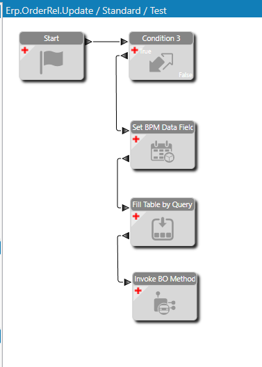

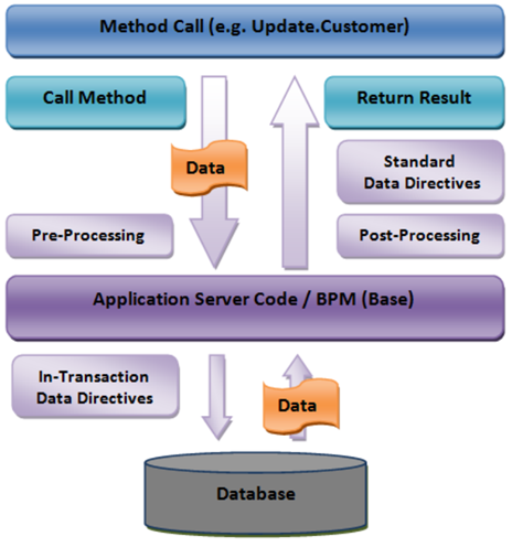

You want to do a Standard DD.
Your Standard DD would be:
  • Condition, does release = 1 and is RowMod = A
  • True, set a BPM field to Pineapple
  • Call Update
  • False, nothing
Your Pre-Processing MD would be:
  • Condition, does BPM field = Pineapple
  • True, set flag and RowMod to U
  • False, nothing
I guess I’m worried that calling a method directive update from a Standard directive would eventually loop through the hierarchy back to standard directive and cause a loop?
Not a 1-1 comparison but I tried having a method directive call itself before using a conditional statement to call itself trying to do a recursive directive and it locked up the server even though I am 99% sure it was written properly in a recursive sense of the phrase. It was a fairly straightforward statement and each time the integer being evaluated should have been decreasing. Ever since then I’ve avoided making any looping directives like this since our test instance shares with our live server.
That is why you would use a Standard DD. That triggers after the record is saved to the DB. There is a clear end to the call and you are initiating a new one. When it goes to save to the DB again, it will evaluate to False because the RowMod is U, not A.

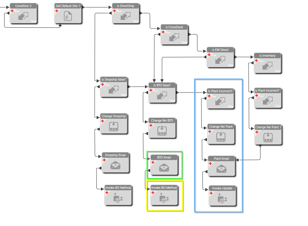

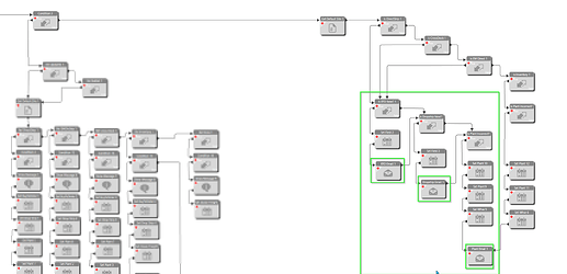

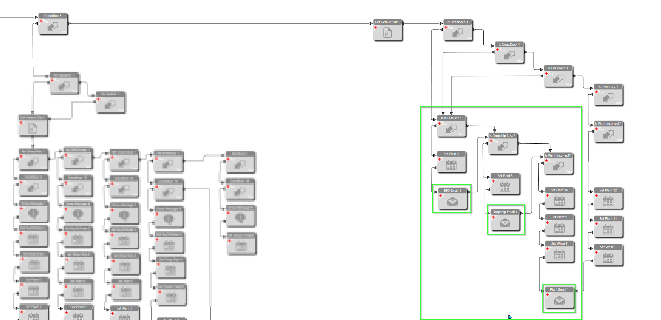

So I have it kind of working - though I see I deviated from your outline a bit. Am I able to calculate and send the dataset from the DD through the Invoke BO widget or do I have to strictly build it inside the method directive?
The green box email does go out, so I know my logic is following down correctly as this was the expected path for my first test case. I wanted to build it this way so I could see it hit each stage, so it would hit BTO, update, then hit the SD and this time hit Plant, update, then hit the SD and exit out.
But when I actually check the release, I don’t have the BTO flag checked.
I tried with only BTO flagged and with all 3 flagged. RowMod is also set to “U”
But hey at least no infinite loop so I’m less scared now.
Edit - secondary problem I spotted I’ll have to rearrange some of the logic since I need BTO to be on prior to turning on Dropship for that first chain but I’m working down the “is CrossDock” chain.
Switched it to do the calculation as described, no difference between calculating for the dataset in the SD or calculating in the update method after I’ve called it.
This time I tested on a drop ship variant. All 3 emails triggered, but the actual release didn’t update. This is when it was fully updated in the method directive.
SD Directive,
  • looking for release = 1 and RowMod = A.
  • Assigned ShortChar01 to “FirstRelease”
  • Got the orderrel the record for it, and sent it in the update method directive.
Then in the update method directive, it
  • checked in the top left “Condition 3” for it to be flagged as “FirstRelease”
  • ran through logic
  • emailed out after setting the fields desired on first release
Emails arrived successfully as expected
But the release itself is missing

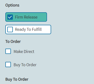

On the other hand, with the firm release flag, this worked fine:
var newReleases = ttOrderRel.Where(x => x.RowMod == "A" && x.FirmRelease == true);
if(newReleases.Count() > 0)
  foreach(var rel in newReleases)
      rel.FirmRelease = false;
