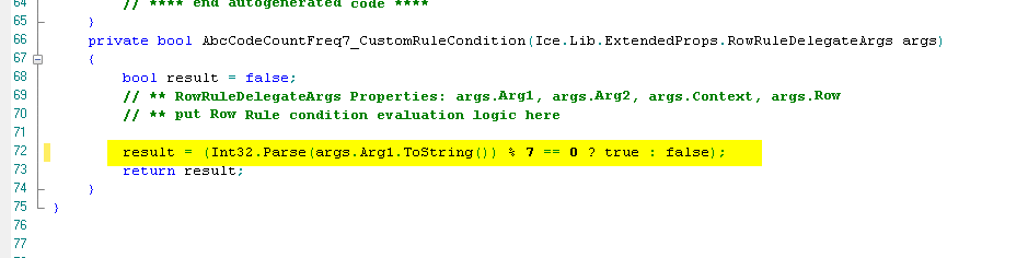

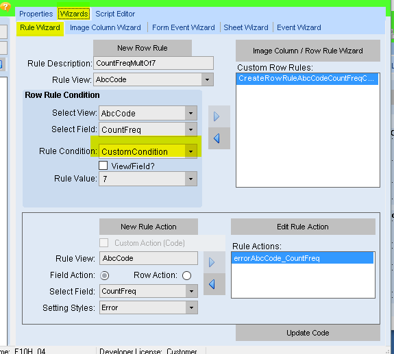

If you did the first, then all you have to do is update the function <rulename>_CustomRuleCondition() to return true when the Rule Action should be applied.
Here’s one that did on ABC Code’s CountFreq field to highlight if it is a multiple of 7.
Code
// Custom code for AbcCodeForm
// Created: 9/10/2020 1:12:36 PM
using System;
using System.ComponentModel;
using System.Data;
using System.Diagnostics;
using System.Windows.Forms;
using Erp.Adapters;
using Erp.UI;
using Ice.Lib;
using Ice.Adapters;
using Ice.Lib.Customization;
using Ice.Lib.ExtendedProps;
using Ice.Lib.Framework;
using Ice.Lib.Searches;
using Ice.UI.FormFunctions;
public class Script
CreateRowRuleAbcCodeCountFreqCustomCondition_7();;
// Begin Custom Code Disposal
// End Custom Code Disposal
private void CreateRowRuleAbcCodeCountFreqCustomCondition_7()
// Description: CountFreqMultOf7
// **** begin autogenerated code ****
RuleAction errorAbcCode_CountFreq = RuleAction.AddControlSettings(this.oTrans, "AbcCode.CountFreq", SettingStyle.Error);
RuleAction[] ruleActions = new RuleAction[] {
errorAbcCode_CountFreq};
// Create RowRule and add to the EpiDataView.
RowRule rrCreateRowRuleAbcCodeCountFreqCustomCondition_7 = new RowRule("AbcCode.CountFreq", new RowRuleConditionDelegate2(this.AbcCodeCountFreq7_CustomRuleCondition), 7, ruleActions);
((EpiDataView)(this.oTrans.EpiDataViews["AbcCode"])).AddRowRule(rrCreateRowRuleAbcCodeCountFreqCustomCondition_7);
// **** end autogenerated code ****
private bool AbcCodeCountFreq7_CustomRuleCondition(Ice.Lib.ExtendedProps.RowRuleDelegateArgs args)
bool result = false;
// ** RowRuleDelegateArgs Properties: args.Arg1, args.Arg2, args.Context, args.Row
// ** put Row Rule condition evaluation logic here
result = (Int32.Parse(args.Arg1.ToString()) % 7 == 0 ? true : false);
return result;
The only line I had to add or modify was the one that sets the value of the result to return in the ...CustomRuleCondition() function.

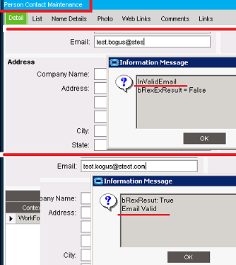

Why are you making this a customization and not a BPM? Server side code will work for any interface, but a customization will only work for this screen. Just a thought…
I’m of the same opinion.
Coincidentally I had been playing with RegEx recently so fiddled around with a form customization for a bit, I was able to get it working… sort of (message pops up multiple times).
When I finally switched to a BPM things became much simpler, easier.
Attached a copy of BPM if your interested in trying that out.
Note that I did very little testing on this one, I was just playing around today. PerCon_RegEx_Email_Validate.bpm (31.4 KB)
