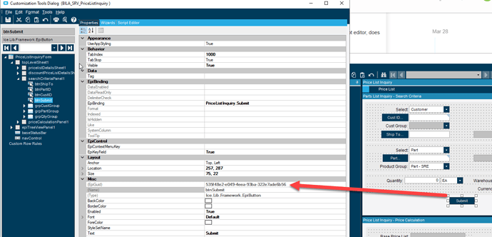

I am trying to fire the PerformClick() event of the submit button (btnUpdate) in the Price List Inquiry screen and it doesn’t appear to be firing.
1.I started out by creating a EpiButton reference with the GUID named btnSubmit, then calling the code btnSubmit.PerformClick(); The IDE didn’t complain but it didn’t seem to do anything on the form.
2. To see if it was being called at all, I attached my own custom event listener to the btnSubmit object to detect if it was being called.
a. When I clicked the submit button manually, my event listener code was in fact being called.
b. When I programatically executed btnSubmit.PerformClick() my event listener code was not being called and it appears that the .PerformClick() was still doing nothing.
3. I tried instantiating the btnSubmit object at the script level as well as at the function level. I know I have a good reference to the submit button because I can change it’s text and so on. I have also initialized the submit object reference in the InitiliazeCustomCode() level as well as trying to initialize it at the function level in which I am using it.
I am new to Epicor and Epicor development but not to software development.
Shouldn’t the following code work?
EpiButton btnSubmit = (EpiButton)csm.GetNativeControlReference(“535f48e2-e049-4eea-93ba-322e7ade6b56”);

2022-03-29_8-22-38
Ok cool, I’m still not sure what specific event you want to trigger that button click though.
I want to fire the submit button click event as seen in the second photo in my previous comment.
Basically when a given criteria is met, I want to programatically execute the submit button’s click event. I hope that makes sense :slight_smile:
