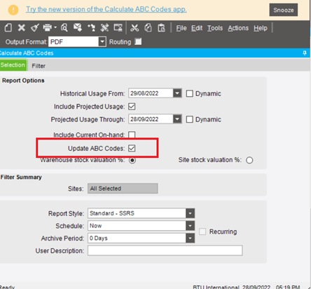

I need to filter the data on the Calc ABC Codes report based on the ABC code value.

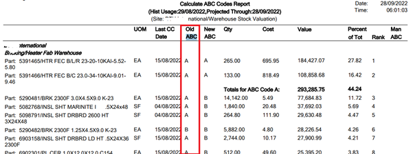

If the old ABC code value is “U” then those records should not be displayed on the report.
also there should not be any ABC Code update for those records that contains the Old ABC Code value as “U”. (If old ABC Code is “U” then new ABC Code should be “U” only)
There should not be any option to filter the data for the system reports.
This report takes more than an hour to generate it. It is very difficult to do any updates and testing on this. Is there any other way to filter the data on this Report?
Can you change your part masters for parts with ABC Code “U” to “Manual ABC Code” - DMT or UBAQ?
Part Maintenance → Sites → Warehouses → Cycle Count sheet → Manual ABC Code
If so… they should then be ignored by Calculate ABC Codes.
