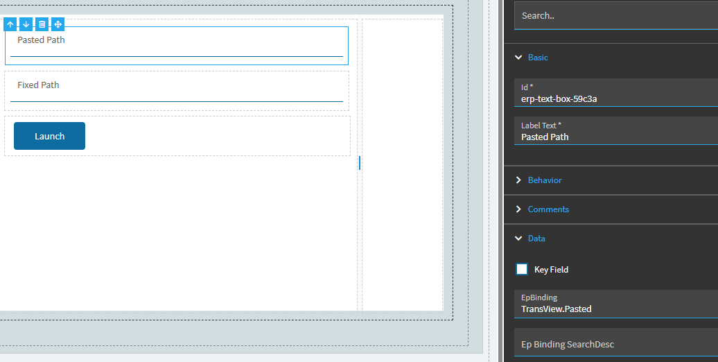

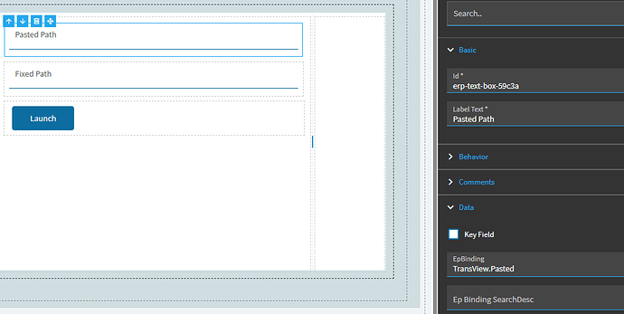

So… sorry about the image dump below, but here was my set-up:
Textbox with EP Binding to TransView.Pasted.
The second text box had an EpBinding to TransView.FixedPath

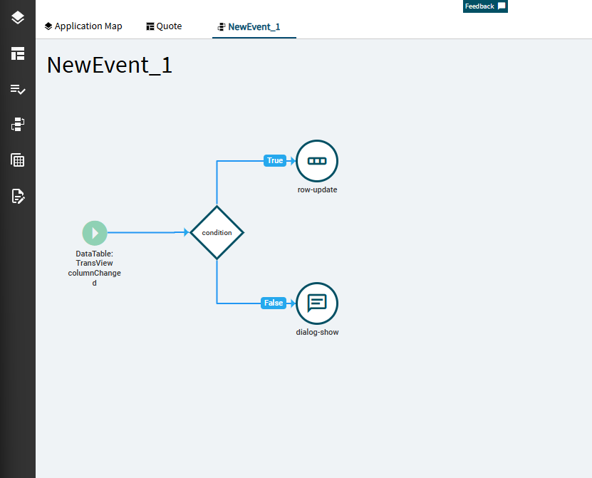

I then created an event so when the value of “Pasted” changes, it will update “FixedPath”.
Trigger:

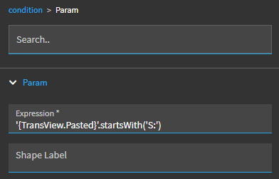

Condition:
Expressoion: '{TransView.Pasted}'.startsWith('S:')

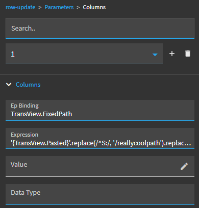

Row-Update:
Expression: '{TransView.Pasted}'.replace(/^S:/, '/reallycoolpath').replace(/\+/g, '/')

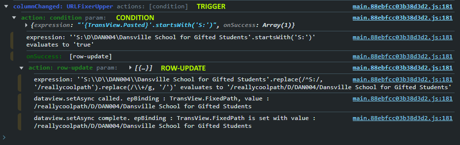

If it works… you should be able to see your event firing in debugger:
This is good, but where you initiate the TransView. What event or how do you set up that event?
If you’re on Quote Entry… TransView is already there and I’m sure Epicor already took care of that. Shouldn’t need to worry about it.
There’s already a system event that initiates it as a dataview:

Can you show your console output?
F12
Tap on kinetic window
Ctrl alt 8
Paste path
Screenshot console
I think the problem is your condition expression above has the “replace” action in it… you’re not looking to replace anything there. You’re just evaluating the current value.
So I initially tested with: '{TransView.Pasted}'.startsWith('S:')
That’s a true/false expression.
You’re not trying to “replace” anything here.
You can check multiple things in a single condition expression… so you could try:
'{TransView.Pasted}'.includes('"') && '{TransView.Pasted}'.startsWith('S:')
edit: to be honest, you know you always what to remove the quotation marks, right? so there’s really no reason to make that part of the condition… just always include that in your row-update expression. That’s where the “replacing needs to happen”.
Also, these are JavaScript expressions, and there is no “.replaceAll()” function.
Instead, you would format your .replace() using “/g”. This serves as a global flag, so the replace will look for all instances in the value.
So, your replace for getting rid of all quotation marks would be:
'{TransView.Pasted}'.replace(/"/g, '')
