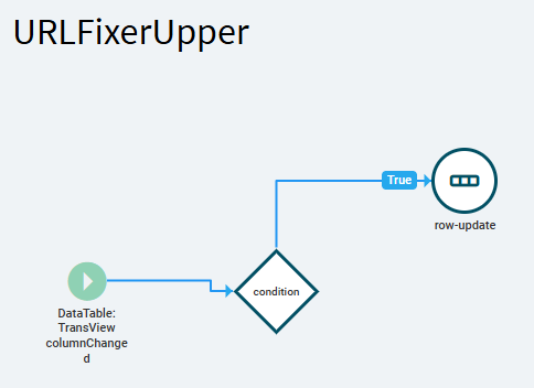

I figured I’d actually test this out… I made a few tweaks:
The Main Event: URL Fixer Upper
If True:

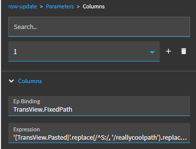

Row-Update Expression:
'{TransView.Pasted}'.replace(/^S:/, '/reallycoolpath').replace(/\+/g, '/')
I added the second replace to switch backslashes (windows) to forward (URLs).

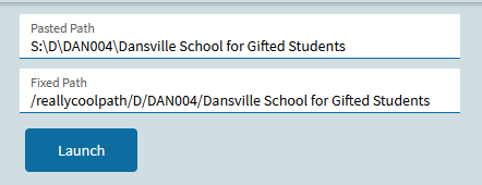

Results:

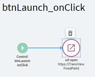

Button click to launch the URL:
Result:
Web browser opens to the below:

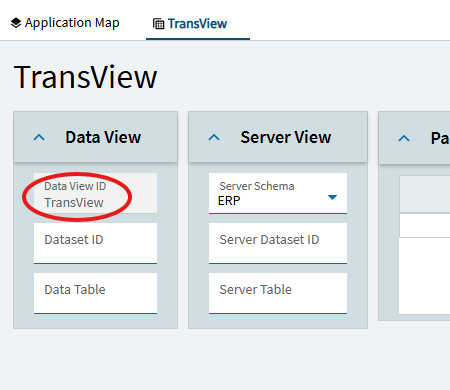

So, if this IS a custom dashboard and you don’t have a temporary dataview… add one.
Just go into your dataview in App Studio, click new, and give your dataview a name:
That’s it.

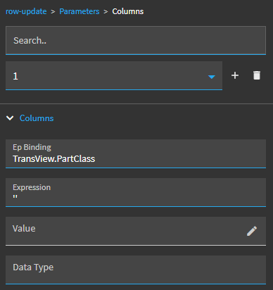

The only other thing you need to do is initiate it at run time. To do that, you just need an event with a row update where you update a random TransView column to… anything. Its just a way to kick the dataview awake.
For example, below I initiate this one by row-update TransView.PartClass to an empty string (‘’).
Once your temp dataview is alive and kicking… you can add columns on the fly. I don’t “define” TransView.Pasted anywhere… but I bound a text box to it. So, then when I paste a value in there and tab out of it… that value is saved to TransView.Pasted. That column gets created automatically as soon as a value is entered into it.
