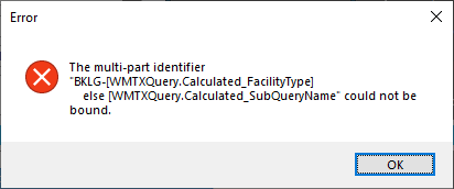

I get the following error:
I will try COALESCE() as well.
before the dot to tell sql this is one piece of information
case
when (WMTXQuery.Calculated_SubQueryName) is NULL
then [BKLG-WMTXQuery].Calculated_FacilityType
else WMTXQuery.Calculated_SubQueryName
end
