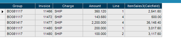

I’m having some issues with creating a calculated field that subtracts an InvoiceAmt from any MiscCharges with a “SHIP” Code attached to it.
So say there’s an invoice with 2 Misc Charges on it, one for “TAX” and one for “SHIP”; I want the calculated field to subtract only the “SHIP” MiscAmt from the InvoiceAmt.
As of right now, I have this: case when InvcMisc.MiscCode = 'SHIP' then InvcHead.InvoiceAmt - InvcMisc.MiscAmt else '0.00' end
Which works only when the invoice has one “SHIP” on it… If the invoice has several lines with a “SHIP” Misc Charge on it then it doesn’t work… I thought since it’s not adding the “SHIP” Misc charges together, it needs a SUM… So I tried: (case when InvcMisc.MiscCode = 'SHIP' then sum(InvcMisc.MiscAmt) else '0.00' end) but that ends up summing all the Misc Charge amounts. (and obviously not using InvoiceAmt at all)

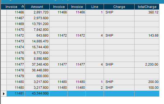

It’s still not working as needed.
As you can see below, on the 11480 invoice there’s two SHIP charges, but it doesn’t calculate the total on one line, it separates it like before.

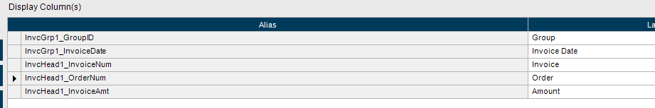

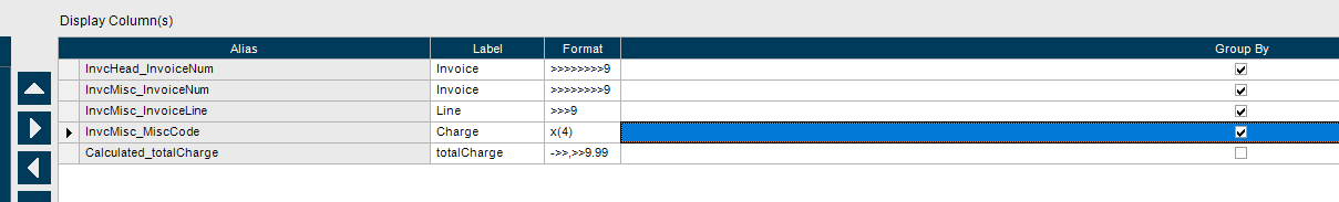

Are you summing and grouping in the sub query? You must have something in the sub that is unique to each line. What display fields do you have in the sub query?
The Subquery’s Display Fields:
and finally
I’ve never made sub querys so excuse any ignorance

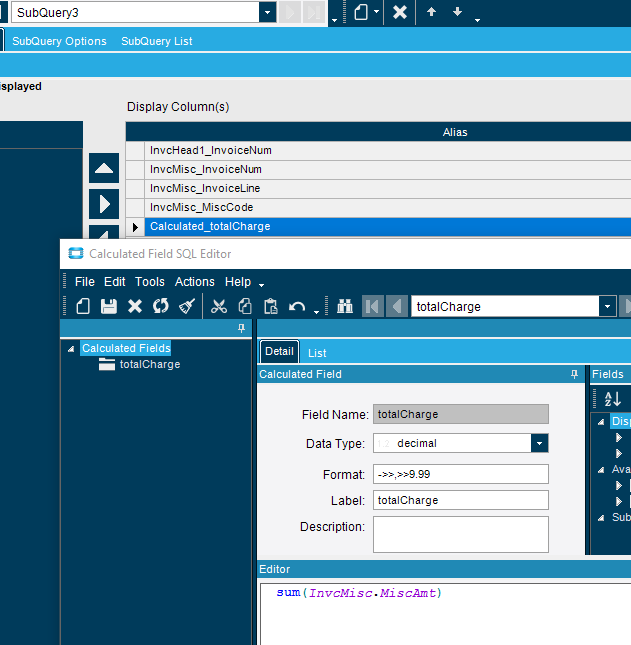

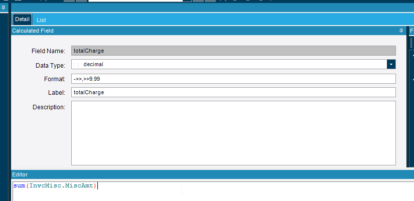

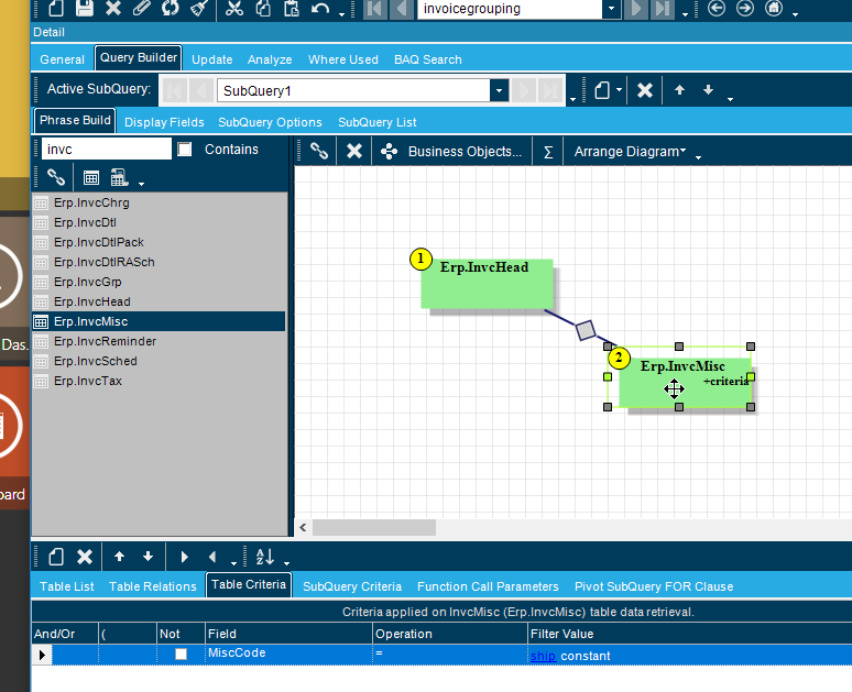

You should be adding up the totals in the sub query, so you should have calculated fields in the the sub queries. It doesn’t look like you are summing and grouping in the sub, so it will return multiple rows (like you are seeing). This would be an example of one of the sub-queries that you are trying to do. You use the criteria in the InvcMisc to only return the SHIP code (we have different codes so that won’t work for our system, but you get the point) Then you add up grouping by only the things you need to identify the matches. It’s easy to get multiple rows by including things you don’t need.

See my edit. You need to filter in the sub
Just bring in the same table on a different level if you want to see all of them.

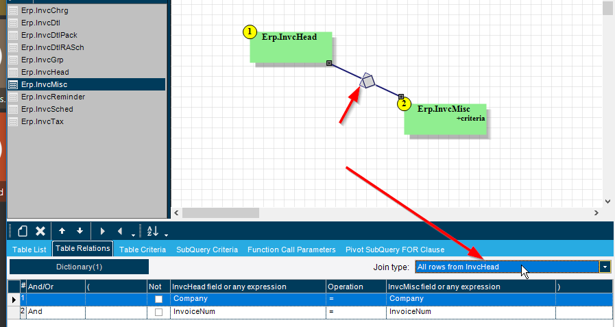

Also don’t forget about left, right, inside and outside joins. They have different names in 10.1 but you can see the join type below. So if you don’t have anything in your sub it will still return a row, just the sub rows will be empty. Then you don’t lose any.
Yep I did a left join for the SubQuerys on the Top Level so that it only shows invoices that are in the InvcGrp or whatever…
So I did all that and still get this:
At the bottom, invoice 11480 still has two different lines for the same ‘SHIP’ charge (Yes they’re on different lines, but I still want them to add up)
Well you have line 1 and line 2 showing on the top level, so they are different rows.
take the invoice line out of that sub and it should work then.
Wow that was a simple little fix.
Thanks Brandon, now the calculated field is working as needed.
