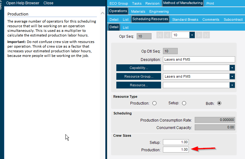

Do you use the crew size in the method? We haven’t used it, so I don’t know how it affect the job or scheduling without testing, but it sounds like what you want.
Hi
We have all the crew sizes setup. We are trying to calculate the cost without raising a job. We have over 30,000 manufactured parts and don’t want to create any more jobs than we need to.

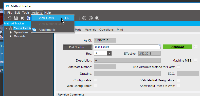

If you go to method tracker on your parent part and click on view costs, does it not roll up?
that is why, i gave you the engineering work bench option at Part level.
