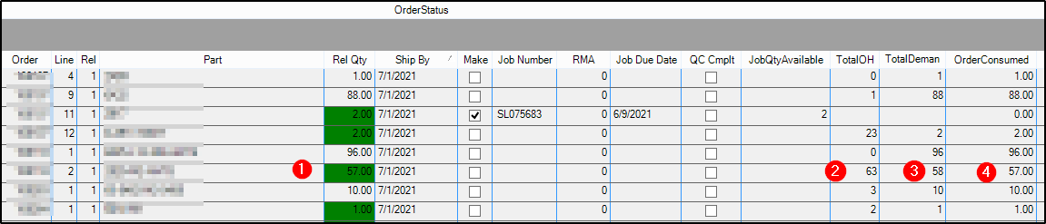

I built an order status report that does some of what you are looking for.
The order consumed column goes down the list for each stocked part and calculates what has been consumed thru that date / order / release. There is another condition on the release qty field to turn green if we can ship the entire amount.
Formula for the Order consumed column
Case
When OrderRel.OpenRelease = 1 and OrderRel.Make = 0
Then Sum (OrderRel.OurReqQty) OVER (PARTITION BY OrderRel.PartNum ORDER BY OrderRel.ReqDate,OrderHed.OrderNum,OrderDtl.OrderLine,OrderRel.OrderRelNum)
Else 0
End
