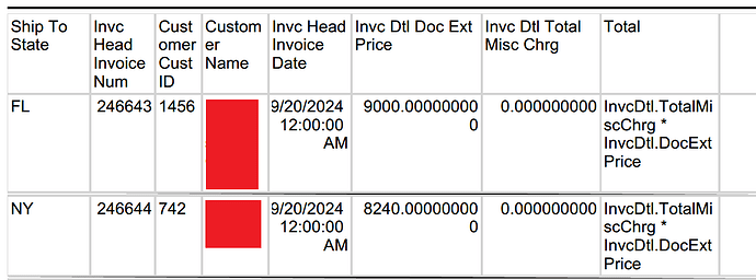

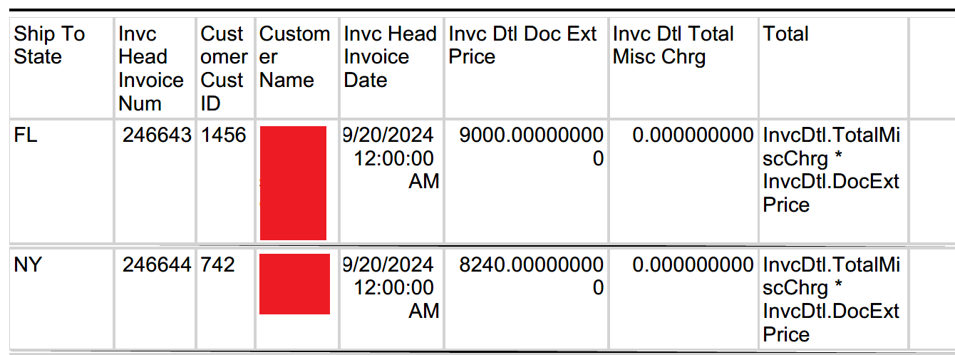

I want to make a calculated field in my report builder. I want to add two columns together. Like such:
InvcDtl.TotalMiscChrg + InvcDtl.DocExtPrice
I am doing this incorrectly, as it only produces just those words on the report.
How would I write this so it produces the result?

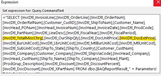

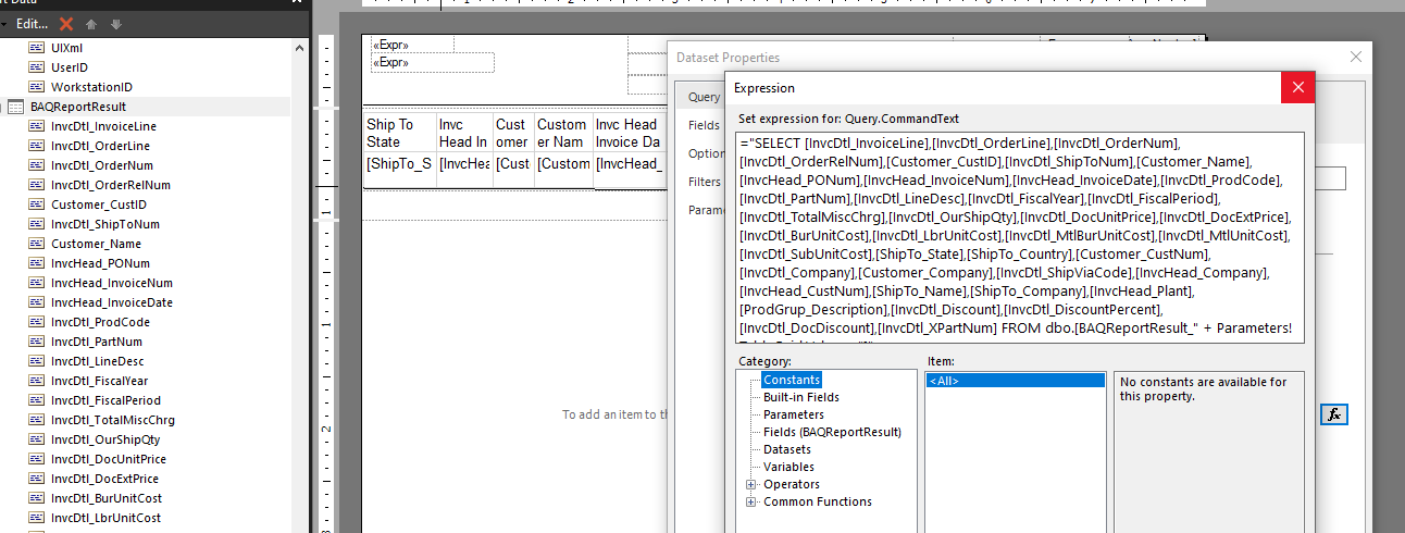

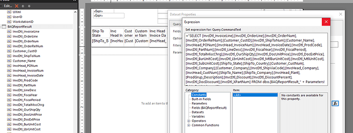

Update: I probably have to add it to the Expression of the dataset itself:
If this is the case, how do I format it correctly?
The error was tell you that TotalMiscChrg is not a valid field… but InvcDtl_TotalMiscChrg is.
You need to use the same field references that are in your query. So, you’ll need to add the table prefixes in your expression:
=Fields!InvcDtl_TotalMiscChrg.Value + Fields!InvcDtl_DocExtPrice.Value

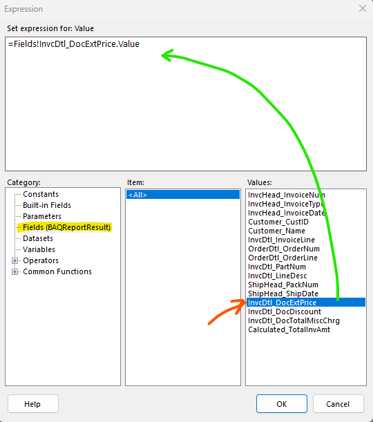

If it helps, in the future, when you’re writing your expressions… in the editor, if you click on the “Fields (BAQReportResult)” on the left, it will show you all the available fields you can use.
Then, if you double-click on the field you want on the right hand side, it will plop it into the expression for you.
