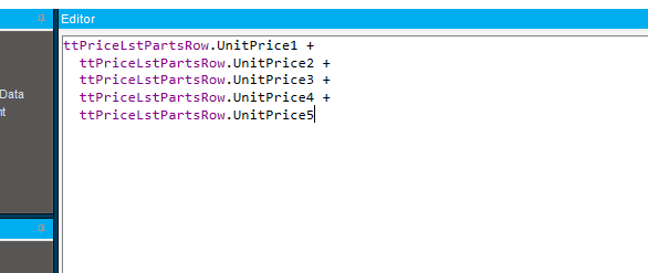

I have this expression in a BPM. I need to round it to the nearest 100th. What do i need to do to accomplish this?
