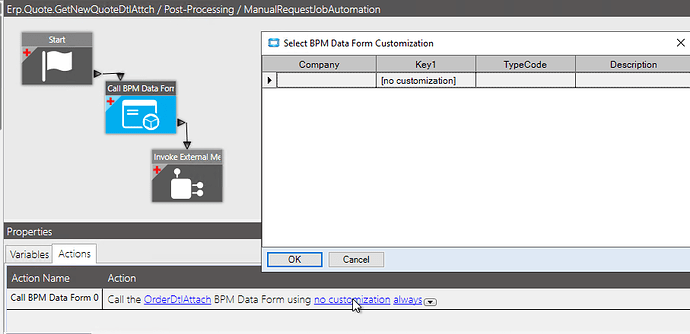

In order to call a BPMDataForm I believe you’ll have to implement CustomizationBase in your class which can very complex. One thing you can do, is call the BPM data form from inside the BPM and then go back to your external DLL with the results.

I thought of that but didn’t give it a try yet thinking it might not be possible. I though with BPMs it’s either you use an External dll which has the same signature that the BPM method itself or you make the flow.
Does that mean I have to change the signature or I keep it as it is and just try to get the answers from callContextBpmData which I assume require also an inheritance but easier to implement.
When you say “Invoke BPM Form” one of the options is “Invoke BPM Form with Customization XXX” you can there pick the customization.
You would have to make the Flow and Invoke your external methods as needed. Then when you need a BPM DataForm you call it from the flow.
giving it a try atm! giving feedback soon!
I do not have cutomization but thats what @josecgomez is talking about. You can always create a basic flow with the designer and than go check in Epicor folder the source code to see exactly how it is used!
EpicorServerName\Server\BPM\Sources\BO\Entity.Method\version
And it was even simpler than I thought. I didn’t need to inherit from any class.

Thnx for the hint @josecgomez. So I assume it doesn’t matter when or how I call an external dll in a BPM flow from now on! :smiley:
