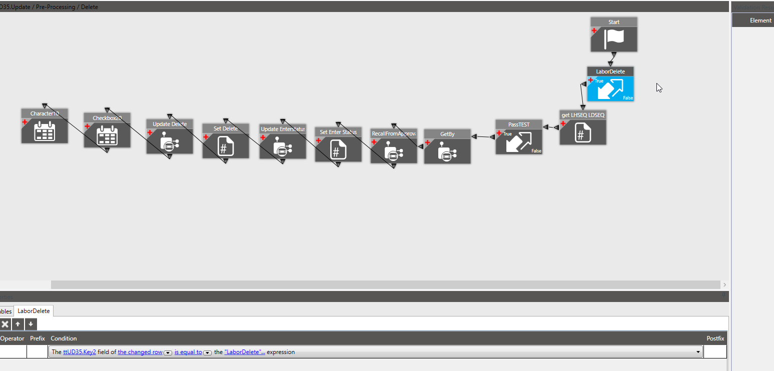

I often call BPM from customization when I am Update dataset.
Here is example of deleting labor detail entry:
From customization:
		UD35Adapter ud35  = new UD35Adapter(oTrans);
		ud35.BOConnect();
		ud35.GetaNewUD35();
		int rowCount = ud35.UD35Data.UD35.Rows.Count;
		DataRow dr = ud35.UD35Data.UD35.Rows[(rowCount-1)];
		dr.BeginEdit();
		string key1 = DateTime.Now.ToString("yyyyMMddHHmmssffffff");
		dr["Key1"] = key1;
		dr["Key2"] = "LaborDelete";
		dr["Number01"] = Convert.ToInt32(gridHistory.ActiveCell.Row.Cells["vw_LaborAlloc_LaborHedSeq"].Value);
		dr["Number02"] = Convert.ToInt32(gridHistory.ActiveCell.Row.Cells["vw_LaborAlloc_LaborDtlSeq"].Value);
		dr.EndEdit();
		ud35.Update();
		ud35.Dispose();
		gridHistory.ActiveCell.Row.Cells["Calculated_Process"].Value = getLaborProcessStatus(key1);
		gridHistory.ActiveCell.Row.Update();
On the BPM Side:
Customizations.pptx (583.6 KB)
