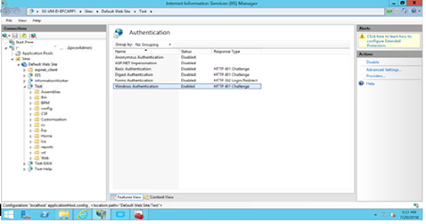

We are using single sign on to login to the Epicor System. We have enabled windows authentication from IIS manager. Please see below screen 1.

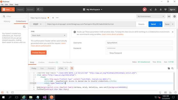

But when We try to access rest service from C#.code in client machine, following error was appeared. This code was copied from other thread in this site. It is attached below. We passed windows login and password to this method. (This is our administrator account)
Error
401 - Unauthorized: Access is denied due to invalid credentials.
You do not have permission to view this directory or page using the credentials that you supplied.
