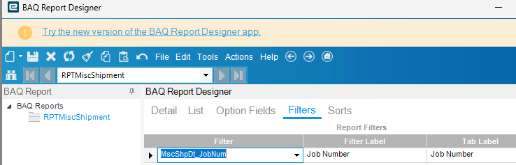

We are using Epicor Version 12.1.1.100.0 (2025.2.10) and have an SSRS BAQ Report MiscShipment , which requires the parameter MscShpDt_JobNum in the BAQ Designer.

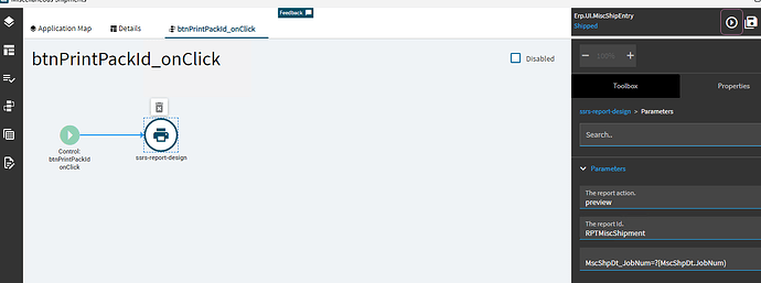

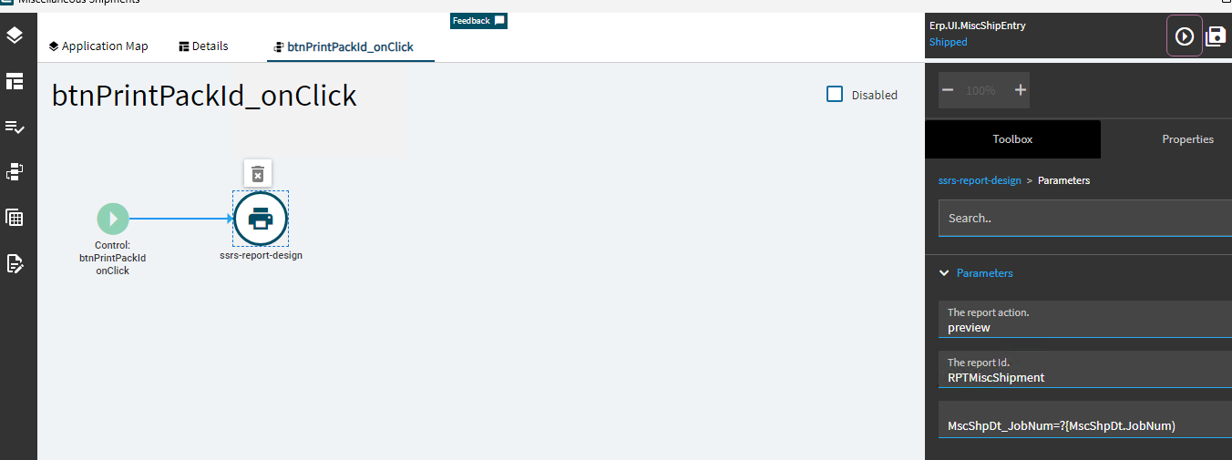

try this but not working
I’ll be honest that I’ve never seen the “ssrs-report-design” action widget in use.
Based on the hover-text, it is reliant on the Edge Agent.

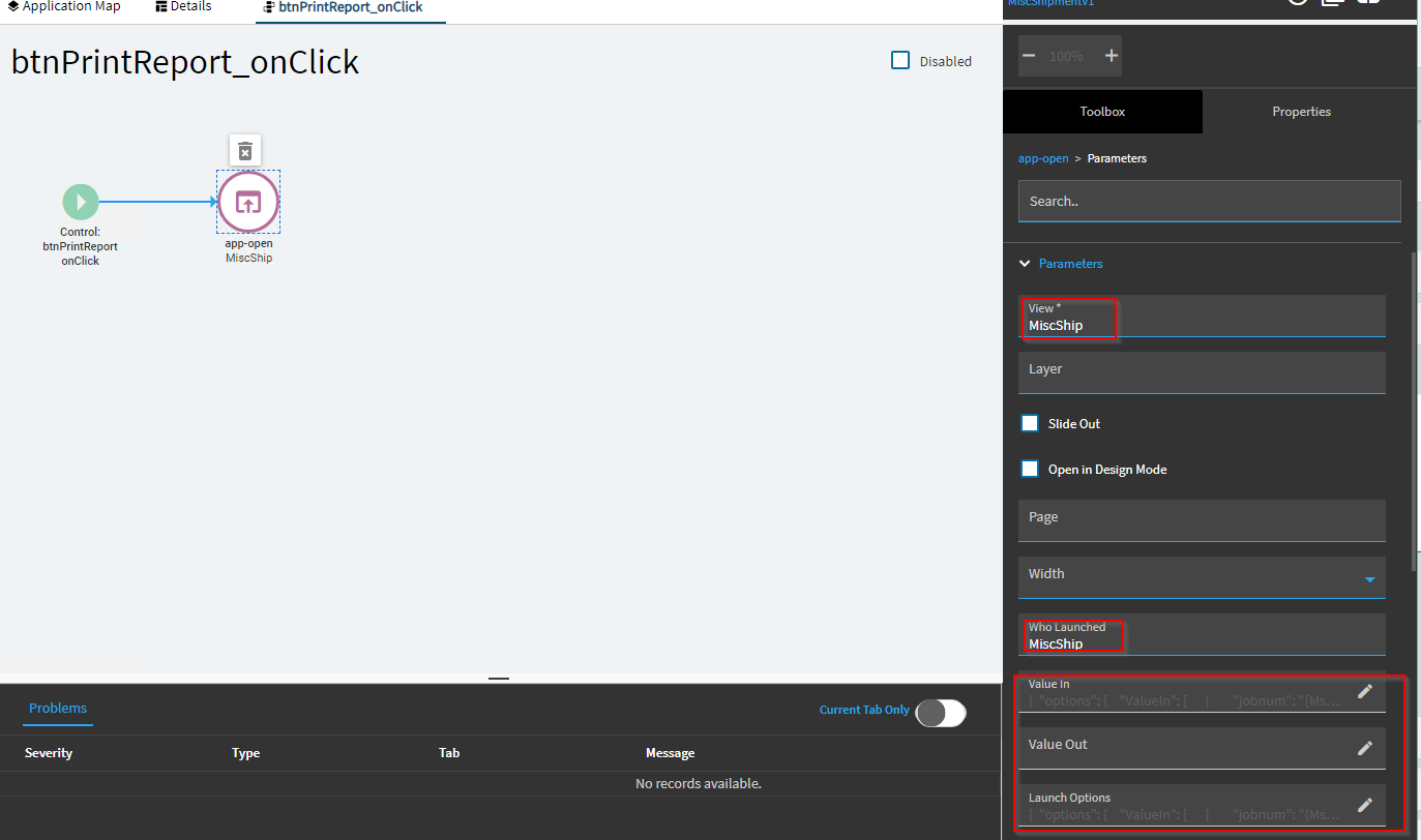

I would approach this by adding your BAQ Report to a menu (if you didn’t already) and use an app-open action instead. You should then be able to pass your values using the app-open’s “Value In” expression.
A condition action prior to the app-open could verify JobNum has value, etc.
You would need an event on the BAQ Report’s app to receive the values and parse them into the required columns.
Here’s an example of an event I have set up in Order Entry where my shipping department can print a label:
Value In:
And here’s the event on my Label application to receive the value in:

@dcamlin approach is what I typically will do if user input is required.

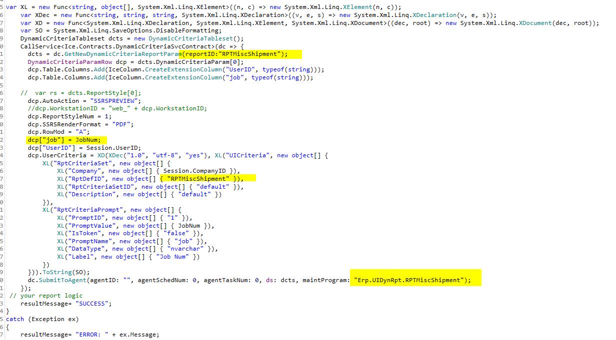

As per your guidance, I created a function with one parameter and am calling it from the Kinetic customization code, but it is not behaving as expected.
I would really appreciate your guidance on resolving this issue in Kinetic.

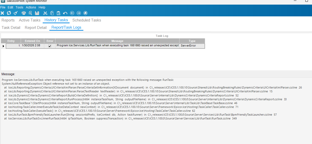

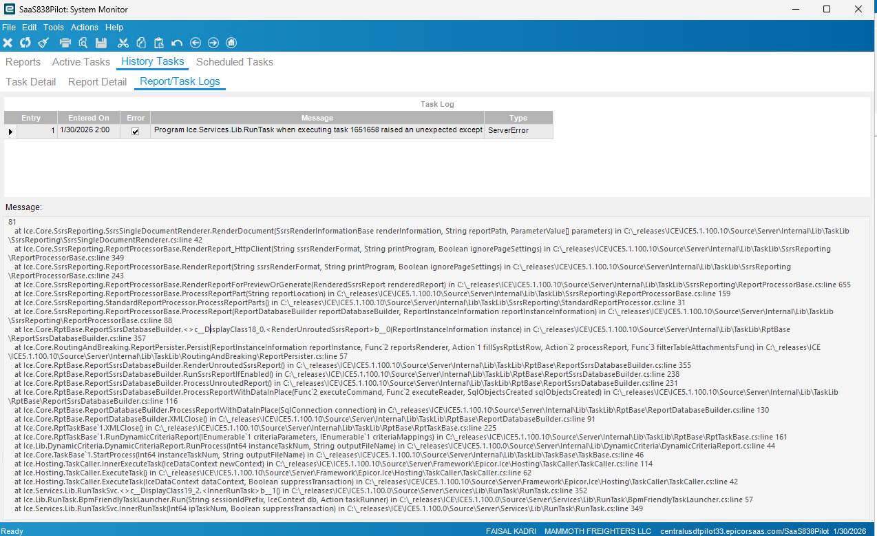

without company parameter below exception
//XL(“Company”, new object { Session.CompanyID ?? “” }),
when adding company param below exception
https:url…/api/v2/efx/778899/MiscShip/PrintMiscShipmentReport/ 500 (Internal Server Error)

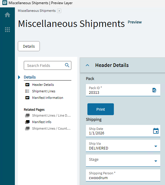

Dear Sir @dcamlin

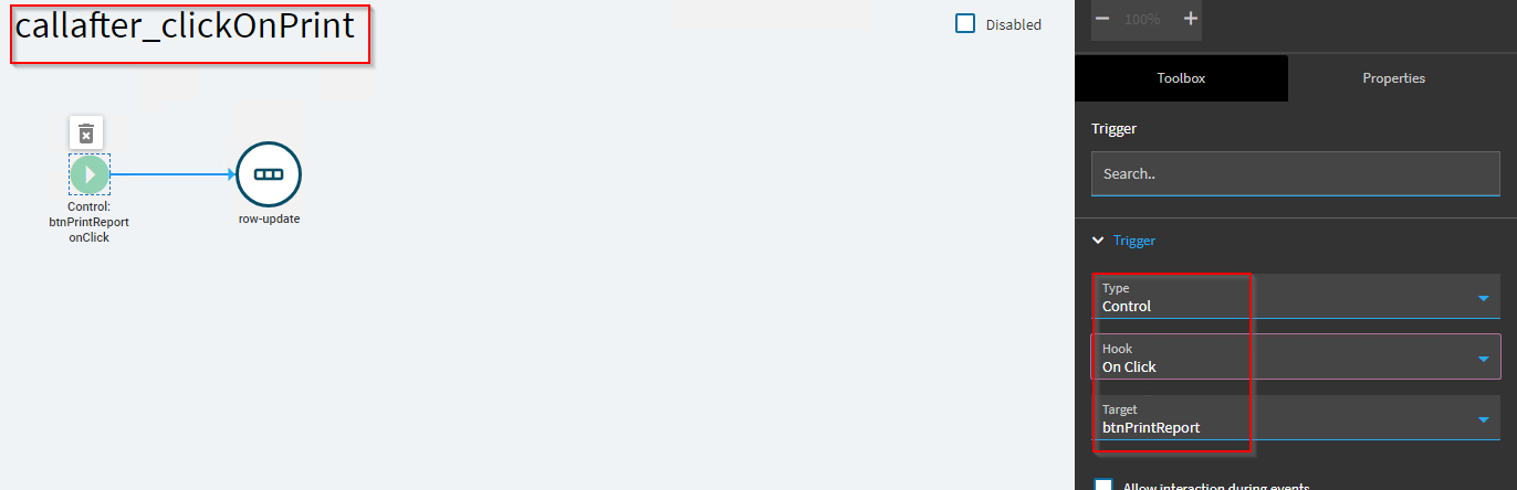

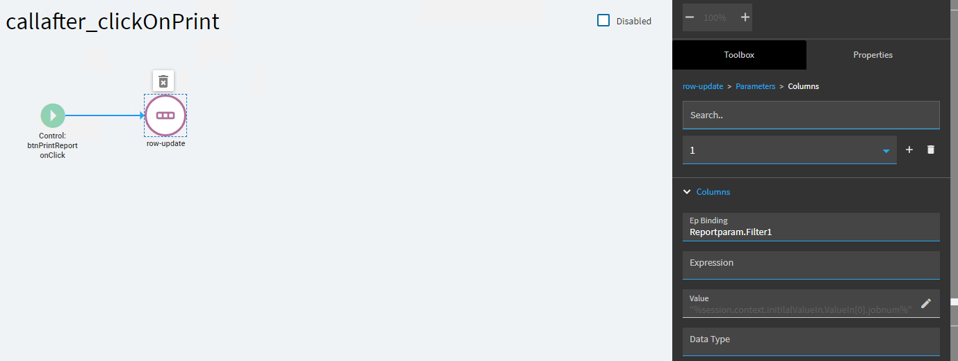

Code in Kenitic

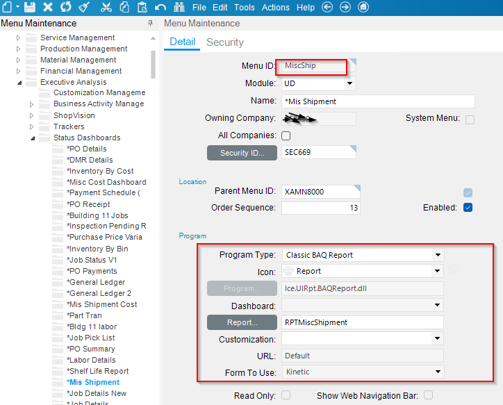

this is added into menu MiscShip
added event callafter_clickOnPrint

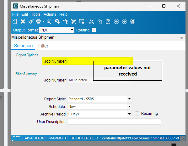

jobnum Values not received
