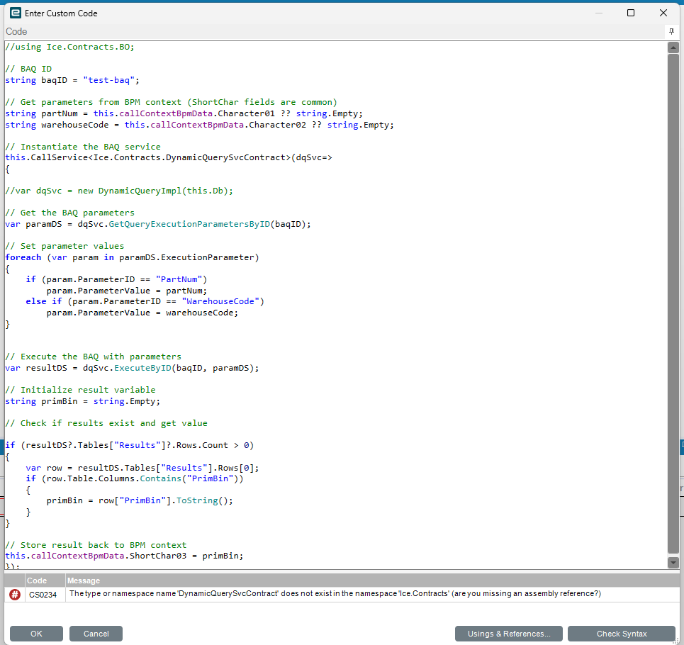

// BAQ ID
string baqID = "test-baq";
// Get parameters from BPM context (ShortChar fields are common)
string partNum = this.callContextBpmData.Character01 ?? string.Empty;
string warehouseCode = this.callContextBpmData.Character02 ?? string.Empty;
// Instantiate the BAQ service
this.CallService<Ice.Contracts.DynamicQuerySvcContract>(dqSvc=>
//var dqSvc = new DynamicQueryImpl(this.Db);
// Get the BAQ parameters
var paramDS = dqSvc.GetQueryExecutionParametersByID(baqID);
// Set parameter values
foreach (var param in paramDS.ExecutionParameter)
    if (param.ParameterID == "PartNum")
        param.ParameterValue = partNum;
    else if (param.ParameterID == "WarehouseCode")
        param.ParameterValue = warehouseCode;
// Execute the BAQ with parameters
var resultDS = dqSvc.ExecuteByID(baqID, paramDS);
// Initialize result variable
string primBin = string.Empty;
// Check if results exist and get value
if (resultDS?.Tables["Results"]?.Rows.Count > 0)
    var row = resultDS.Tables["Results"].Rows[0];
    if (row.Table.Columns.Contains("PrimBin"))
        primBin = row["PrimBin"].ToString();
// Store result back to BPM context
this.callContextBpmData.ShortChar03 = primBin;
Try that.

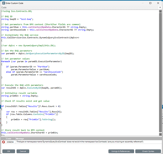

hell, still not working
even with the using ICE.contracts.BO or not.. error

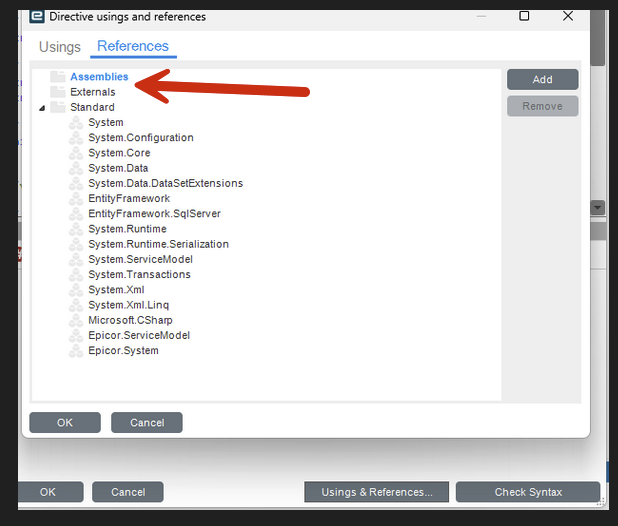

Can you show me your reference? In the using and references button?

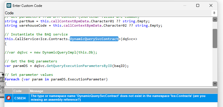

And while you’re in there, can you double click on the error and see which line it brings you to?
double click line

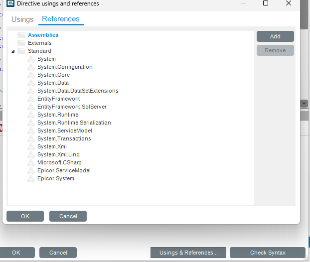

using window
reference window

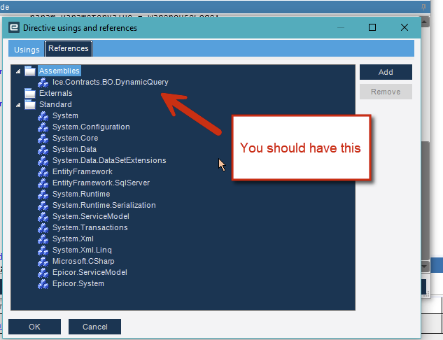

You’re missing the assembly for DynamicQuery.
it took forever to appear.. at least 30 sec.. not sure why..
no errors anymore..
thanks, your the best
