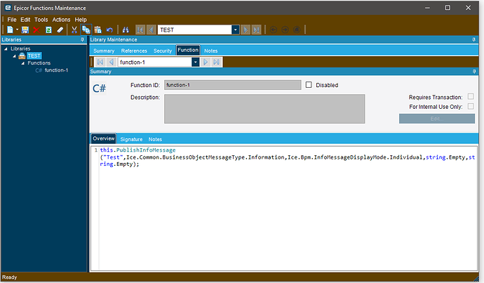

If you are getting 500 error (what is the message)
What does your function look like (what is it doing)
Go to the Server and look at the Event Viewer on that 500 error it should give you more details.
Then double check the variables you are passing are not null, named correctly, are in the proper type etc.
I’d also comment out everything and just pass back a debug message first.
okay, that helps, cuz I can see my message that I send at the top of the function in the response body…that should mean I can add more of those and see how far I am getting before failure…I would have never noticed that in the response, thanks !
that is a good idea also…going to get this yet…thanks

I figured out that my swagger call is now working,
so my last (??) question is can I get that entire response (with the message from PublishInfoMessage) to look at when I’m calling my function via rest in my customization code ?
then I think I’d be able to work thru this
