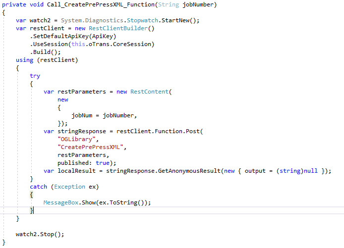

I have chunk of custom code that executes on a button press on a form.
I would like my custom code to call a function using the REST api.
I already have two examples of this in the custom code, calling other functions in the same library.
So I followed the examples and tweaked for my new function, the code looks like this:
I am debugging the custom code in Visual Studio and I know the above is getting executed.
There are no exceptions being thrown, no error messages.
I have a message popup first thing in the function code, which never shows up.
So it appears It’s not being called
Looking for ideas on how to debug/fix this.

My function does throw up a message (I didn’t mean literally Message.Show()).
I know this cause my function is also used by a BPM that is tied to a form and when it’s invoked I get the message. (wouldn’t that be a similar case, or no ?)
This is the code I’m using in my function to show the message:
but…putting debug data in there isn’t going to help me because this is the first line in my function and it doesn’t appear.

Ok, swagger gave me:
500 Internal server error. Server is unable to process the request.
I’m still confused about why it works in my method directive (call function)
but not my custom code…call function
they both are running server side correct ?

He’s calling a function from the client through the rest helper.
Yes, I have a screen customization calling a function (code function not widget function) via rest api.
I also have a method directive calling the same function.
the first thing the function does is pop open a message (which works when calling from the bpm)
but calling the function from the screen custom code does not
this (and the swagger response) makes me believe it’s not even getting to my function in the screen customization case
