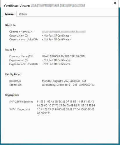

Kevin, I STILL can’t get the REST call to work! Below is a screenshot of the Certificate Viewer for the certificate the site is using:
The certificate says the algorithm being used is PKCS #1 SHA-512 With RSA Encryption, but I’m using the SHA-256 hash in the screenshot. I can still run a successfull test from the REST Help page on the server. Any ideas?
Are you checking the correct hash type?
let’s see your code
