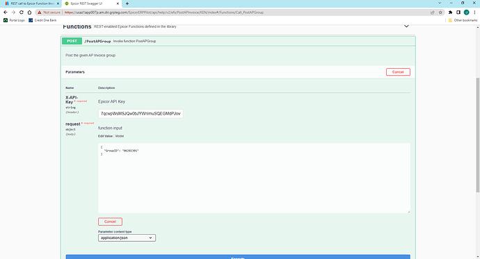

Kevin, hopefully one last issue… I installed RestSharp 110.2.0 in my project and used the example from the link above to code a POST call to my Epicor function. Below is the code I created and a Swagger page showing the function call I’m trying to make. The function call works fine in Swagger, however it’s failing without any error when calling from the RestSharp code. Do I need to deserialize the argument data in the request to call the function, or is there something else I have screwed up?
        private static void CallPostFunction()
            try
                var options = new RestClientOptions(Properties.Settings.Default.AppServerURL);
                options.Authenticator = new HttpBasicAuthenticator(Properties.Settings.Default.BatchEntryPerson, Properties.Settings.Default.BatchEntryPass);
                var client = new RestClient(options);
                var request = new RestRequest();
                request.AddHeader("Accept", "application/json");
                request.AddHeader("X-API-Key", Properties.Settings.Default.APIKey);
                request.Method = Method.Post;
                string RequestContent = "\"GroupID\":" + $@"{BatchGroupID}";
                request.AddParameter("application/json", RequestContent, ParameterType.RequestBody);
                var response = client.Execute(request);
            catch (Exception e)
                throw new Exception("REST Call", e);
That translates to:
"GroupID": somegroupID
You need something more like:
    "GroupID": "somegroupID"
So either build the json with a new object and serialize it, or fix your json string manually:
Serialize Object:
var requestContentObj = new
    GroupID = $"{BatchGroupID}"
string requestContent = JsonConvert.SerializeObject(requestContentObj);
JsonConvert is part of Newtonsoft.Json.
Manually build via string:
string RequestContent = $"{\"GroupID\": \"{BatchGroupID}\"}";

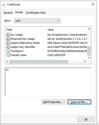

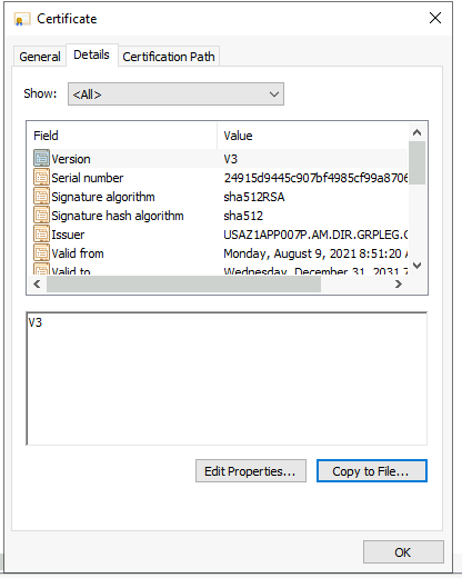

Kevin, I found a certificate that IIS is using on the server to which I’m issueing the REST call that is not expired. To verify the certificate like you indicated, where would I find the hash value? I have a screenshot of the certificate details below, would it be the Thumbprint or Serial Number value?
Easiest way would be to run that snippet I gave you modified to print it out.
Kevin, the code snippet isn’t working, I think due to the version I’m using (110.2.0). VS is saying the RemoteCertificateValidationCallback is under the RestClientOptions class, so I set up the code like this:
                    RemoteCertificateValidationCallback = (sender, certificate, chain, sslPolicyErrors) =>
                        string certHash = "";
                        certHash = certificate.GetCertHashString(System.Security.Cryptography.HashAlgorithmName.SHA512);
                        Console.WriteLine(certHash);
What do I need to do to remedy this?
