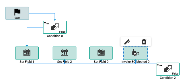

Here’s the overall bpm
The first condition is just making sure this fires on the right update.

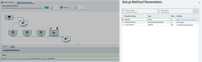

The three set field widgets all set parts of a QueryExecutionTableset variable; ParameterID, ValueType, and ParameterValue. In my case I have QuoteNum as a parameter so that’s QuoteNum (that’s what I named the parameter in the baq), int, and then the quote number associated with this update method.

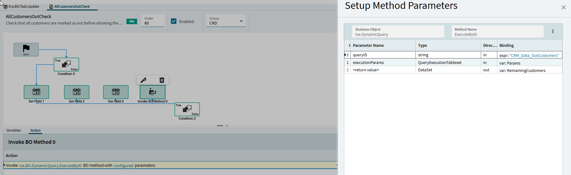

Here’s the Invoke BO Method info
The only way I could figure out to return the data if there was any was a condition widget where custom code is valid. I had to add System.text to the using directives.
