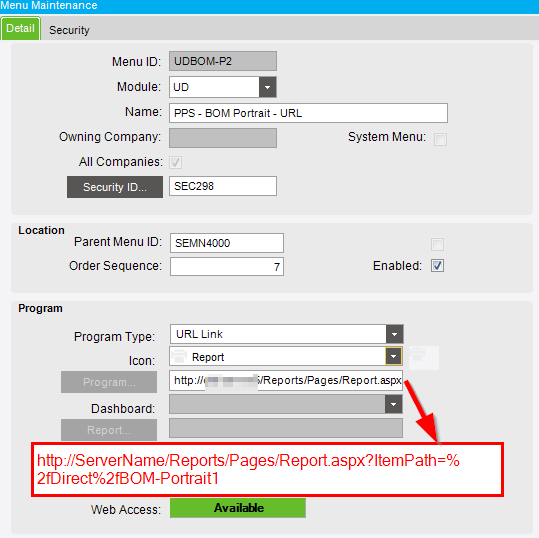

I have several custom SSRS reports, and I use “URL Link”, rather than SSRS Custom Report Link. I can’t remember why or what the difference is, but you could try to follow this example:
