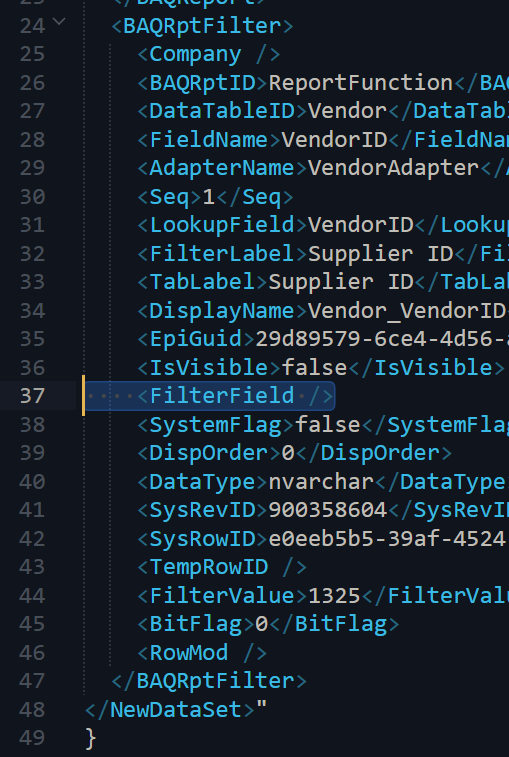

    var paramRow = baqParamTable.NewRow();
	// Set values for all columns
	paramRow["AgentCompareString"] = "";
	paramRow["AgentID"] = "";
	paramRow["AgentSchedNum"] = 0;
	paramRow["AgentTaskNum"] = 0;
	paramRow["ArchiveCode"] = 0;
	paramRow["AttachmentType"] = "Excel";
	paramRow["AutoAction"] = "SSRSPrint";
	paramRow["BAQID"] = "";
	paramRow["BAQRptID"] = "";
	paramRow["Character01"] = "";
	paramRow["Character02"] = "";
	paramRow["Character03"] = "";
	paramRow["Character04"] = "";
	paramRow["Character05"] = "";
	paramRow["Check01"] = false;
	paramRow["Check02"] = false;
	paramRow["Check03"] = false;
	paramRow["Check04"] = false;
	paramRow["Check05"] = false;
	paramRow["Check06"] = false;
	paramRow["Check07"] = false;
	paramRow["Check08"] = false;
	paramRow["Check09"] = false;
	paramRow["Check10"] = false;
	paramRow["Date01"] = DBNull.Value;
	paramRow["Date01Token"] = "";
	paramRow["Date02"] = DBNull.Value;
	paramRow["Date02Token"] = "";
	paramRow["Date03"] = DBNull.Value;
	paramRow["Date03Token"] = "";
	paramRow["Date04"] = DBNull.Value;
	paramRow["Date04Token"] = "";
	paramRow["Date05"] = DBNull.Value;
	paramRow["Date05Token"] = "";
	paramRow["DateFormat"] = "m/d/yyyy";
	paramRow["DecimalsCost"] = 0;
	paramRow["DecimalsGeneral"] = 0;
	paramRow["DecimalsPrice"] = 0;
	paramRow["DesignMode"] = false;
	paramRow["EMailBCC"] = "";
	paramRow["EMailBody"] = "Test - see attached";
	paramRow["EMailCC"] = "";
	paramRow["EMailTo"] = ""; //removed for epiforum post - full email address here
	paramRow["FaxNumber"] = "";
	paramRow["FaxSubject"] = "Aged Receivables - test";
	paramRow["FaxTo"] = "";
	paramRow["Filter1"] = "";
	paramRow["Filter2"] = "";
	paramRow["Filter3"] = "";
	paramRow["Filter4"] = "";
	paramRow["Filter5"] = "";
	paramRow["Filter6"] = "";
	paramRow["Filter7"] = "";
	paramRow["Filter8"] = "";
	paramRow["Filter9"] = "";
	paramRow["Filter10"] = "";
	paramRow["GlbDecimalsCost"] = 0;
	paramRow["GlbDecimalsGeneral"] = 0;
	paramRow["GlbDecimalsPrice"] = 0;
	paramRow["Number01"] = 0;
	paramRow["Number02"] = 0;
	paramRow["Number03"] = 0;
	paramRow["Number04"] = 0;
	paramRow["Number05"] = 0;
	paramRow["NumericFormat"] = ",.";
	paramRow["Option01"] = "Heath Croydon";
	paramRow["Option02"] = "";
	paramRow["Option03"] = "";
	paramRow["Option04"] = "";
	paramRow["Option05"] = "";
	paramRow["Option06"] = "";
	paramRow["Option07"] = "";
	paramRow["Option08"] = "";
	paramRow["Option09"] = "";
	paramRow["Option10"] = "";
	paramRow["PrintReportParameters"] = false;
	paramRow["PrinterName"] = "";
	paramRow["ProcessCompany"] = "";
	paramRow["ProcessID"] = "";
	paramRow["ProcessSystemCode"] = "";
	paramRow["ProcessTaskNum"] = 0;
	paramRow["RecurringTask"] = false;
	paramRow["ReportCultureCode"] = "en-US";
	paramRow["ReportCurrencyCode"] = "USD";
	paramRow["ReportID"] = "LCI_Agd_Rcv_01";
	paramRow["ReportStyleNum"] = 1;
	paramRow["ReportTitle"] = "";
	paramRow["RowMod"] = "A";
	paramRow["RptPageSettings"] = "";
	paramRow["RptPrinterSettings"] = "";
	paramRow["RptVersion"] = "";
	paramRow["SSRSEnableRouting"] = false;
	paramRow["SSRSRenderFormat"] = "PDF";
	paramRow["SortBy"] = "";
	paramRow["SortFields"] = "";
	paramRow["Summary"] = false;
	paramRow["SysRowID"] = "00000000-0000-0000-0000-000000000000";
	paramRow["TaskNote"] = "";
	paramRow["UIXml"] = "";
	paramRow["UserID"] = "";
	paramRow["WorkstationID"] = "web_cstlouis";
	// Continue for all the other columns you have (keep adding them like the above lines)
	baqParamTable.Rows.Add(paramRow);
    myds.Tables.Add(baqParamTable);
    // ReportStyle table
    var reportStyleTable = new System.Data.DataTable("ReportStyle");
	reportStyleTable.Columns.Add("AllowGenerateEDI", typeof(bool));
	reportStyleTable.Columns.Add("AllowResetAfterSubmit", typeof(bool));
	reportStyleTable.Columns.Add("BitFlag", typeof(int));
	reportStyleTable.Columns.Add("CGCCode", typeof(string));
	reportStyleTable.Columns.Add("CertExpiration", typeof(DateTime));
	reportStyleTable.Columns.Add("CertificateID", typeof(string));
	reportStyleTable.Columns.Add("CertificateIsAllComp", typeof(bool));
	reportStyleTable.Columns.Add("CertificateIsSystem", typeof(bool));
	reportStyleTable.Columns.Add("Company", typeof(string));
	reportStyleTable.Columns.Add("CompanyList", typeof(string));
	reportStyleTable.Columns.Add("FormatCulture", typeof(string));
	reportStyleTable.Columns.Add("HasBAQOrEI", typeof(bool));
	reportStyleTable.Columns.Add("IsBAQReport", typeof(bool));
	reportStyleTable.Columns.Add("LangNameID", typeof(string));
	reportStyleTable.Columns.Add("LangNameIDDescription", typeof(string));
	reportStyleTable.Columns.Add("OutputEDI", typeof(string));
	reportStyleTable.Columns.Add("OutputLocation", typeof(string));
	reportStyleTable.Columns.Add("PrintProgram", typeof(string));
	reportStyleTable.Columns.Add("PrintProgramOptions", typeof(string));
	reportStyleTable.Columns.Add("ReportID", typeof(string));
	reportStyleTable.Columns.Add("ReportRptDescription", typeof(string));
	reportStyleTable.Columns.Add("RequireSubmissionID", typeof(bool));
	reportStyleTable.Columns.Add("RoutingRuleEnabled", typeof(bool));
	reportStyleTable.Columns.Add("RowMod", typeof(string));
	reportStyleTable.Columns.Add("RptCriteriaSetID", typeof(string));
	reportStyleTable.Columns.Add("RptDefID", typeof(string));
	reportStyleTable.Columns.Add("RptDefRptDescription", typeof(string));
	reportStyleTable.Columns.Add("RptDefSystemFlag", typeof(bool));
	reportStyleTable.Columns.Add("RptStructuredOutputDefID", typeof(string));
	reportStyleTable.Columns.Add("RptTypeID", typeof(string));
	reportStyleTable.Columns.Add("RptTypeRptTypeDescription", typeof(string));
	reportStyleTable.Columns.Add("SSRSRenderFormat", typeof(string));
	reportStyleTable.Columns.Add("ServerNum", typeof(int));
	reportStyleTable.Columns.Add("Status", typeof(int));
	reportStyleTable.Columns.Add("StatusCode", typeof(int));
	reportStyleTable.Columns.Add("StatusDesc", typeof(string));
	reportStyleTable.Columns.Add("StatusMessage", typeof(string));
	reportStyleTable.Columns.Add("StructuredOutputAlgorithm", typeof(string));
	reportStyleTable.Columns.Add("StructuredOutputCertificateExpirationDate", typeof(DateTime));
	reportStyleTable.Columns.Add("StructuredOutputCertificateID", typeof(string));
	reportStyleTable.Columns.Add("StructuredOutputCertificateIsAllComp", typeof(bool));
	reportStyleTable.Columns.Add("StructuredOutputCertificateIsSystem", typeof(bool));
	reportStyleTable.Columns.Add("StructuredOutputEnabled", typeof(bool));
	reportStyleTable.Columns.Add("StyleDescription", typeof(string));
	reportStyleTable.Columns.Add("StyleNum", typeof(int));
	reportStyleTable.Columns.Add("SysRevID", typeof(int));
	reportStyleTable.Columns.Add("SysRowID", typeof(string));
	reportStyleTable.Columns.Add("SystemFlag", typeof(bool));
	// Create a row and populate it
	var row = reportStyleTable.NewRow();
	row["AllowGenerateEDI"] = false;
	row["AllowResetAfterSubmit"] = false;
	row["BitFlag"] = 0;
	row["CGCCode"] = "";
	row["CertExpiration"] = DBNull.Value;
	row["CertificateID"] = DBNull.Value;
	row["CertificateIsAllComp"] = false;
	row["CertificateIsSystem"] = false;
	row["Company"] = ""; //correct company id added here... removed for forum post
	row["CompanyList"] = ""; //correct company id added here... removed for forum post
	row["FormatCulture"] = "";
	row["HasBAQOrEI"] = false;
	row["IsBAQReport"] = false;
	row["LangNameID"] = "";
	row["LangNameIDDescription"] = "";
	row["OutputEDI"] = "";
	row["OutputLocation"] = "Database";
	row["PrintProgram"] = "reports/CustomReports/LCI_Agd_Rcvable";
	row["PrintProgramOptions"] = "";
	row["ReportID"] = "LCI_Agd_Rcv_01";
	row["ReportRptDescription"] = "";
	row["RequireSubmissionID"] = false;
	row["RoutingRuleEnabled"] = false;
	row["RowMod"] = "";
	row["RptCriteriaSetID"] = DBNull.Value;
	row["RptDefID"] = "LCI_Agd_Rcv_01";
	row["RptDefRptDescription"] = "";
	row["RptDefSystemFlag"] = false;
	row["RptStructuredOutputDefID"] = DBNull.Value;
	row["RptTypeID"] = "SSRS";
	row["RptTypeRptTypeDescription"] = "";
	row["SSRSRenderFormat"] = "PDF";
	row["ServerNum"] = 0;
	row["Status"] = 0;
	row["StatusCode"] = 0;
	row["StatusDesc"] = "";
	row["StatusMessage"] = "";
	row["StructuredOutputAlgorithm"] = DBNull.Value;
	row["StructuredOutputCertificateExpirationDate"] = DBNull.Value;
	row["StructuredOutputCertificateID"] = DBNull.Value;
	row["StructuredOutputCertificateIsAllComp"] = false;
	row["StructuredOutputCertificateIsSystem"] = false;

Hey Kevin, any idea how to go about passing a Filter to the BAQ Report in these examples? Made a simple test report that dumps out all of our Inactive Vendors information with Vendor ID as an optional filter. My function generates the report fine, just can’t seem to modify the XML in a way that will actually filter and return a single Vendor.
XML string (assigned to baqParams.Filter1) with no filtering:
  "xmlResp": "<NewDataSet>\r\n  <BAQReport>\r\n    <Company />\r\n    <BAQRptID>ReportFunction</BAQRptID>\r\n    <Description>Test for executing BAQ report from a function</Description>\r\n    <ReportTitle />\r\n    <FormTitle>BAQ Report Function Testing</FormTitle>\r\n    <ExportID>ReportFunctionTest</ExportID>\r\n    <SystemFlag>false</SystemFlag>\r\n    <Completed>false</Completed>\r\n    <GlobalReport>false</GlobalReport>\r\n    <IsCrystalReport>false</IsCrystalReport>\r\n    <ReportID>ReportFunction</ReportID>\r\n    <CrystalReportName />\r\n    <CGCCode />\r\n    <SSRSReportName>ReportFunction.rdl</SSRSReportName>\r\n    <SysRevID>900348189</SysRevID>\r\n    <SysRowID>30ace856-a0b3-418e-9819-886d2f87872b</SysRowID>\r\n    <TempRowID />\r\n    <BitFlag>0</BitFlag>\r\n    <RowMod />\r\n  </BAQReport>\r\n  <BAQRptFilter>\r\n    <Company />\r\n    <BAQRptID>ReportFunction</BAQRptID>\r\n    <DataTableID>Vendor</DataTableID>\r\n    <FieldName>VendorID</FieldName>\r\n    <AdapterName>VendorAdapter</AdapterName>\r\n    <Seq>1</Seq>\r\n    <LookupField>VendorID</LookupField>\r\n    <FilterLabel>Supplier ID</FilterLabel>\r\n    <TabLabel>Supplier ID</TabLabel>\r\n    <DisplayName>Vendor_VendorID</DisplayName>\r\n    <EpiGuid>29d89579-6ce4-4d56-adfd-2cf395b0269c</EpiGuid>\r\n    <IsVisible>false</IsVisible>\r\n    <FilterField />\r\n    <SystemFlag>false</SystemFlag>\r\n    <DispOrder>0</DispOrder>\r\n    <DataType>nvarchar</DataType>\r\n    <SysRevID>900358604</SysRevID>\r\n    <SysRowID>e0eeb5b5-39af-4524-a9de-0d5a981549f0</SysRowID>\r\n    <TempRowID />\r\n    <FilterValue />\r\n    <BitFlag>0</BitFlag>\r\n    <RowMod />\r\n  </BAQRptFilter>\r\n</NewDataSet>"
The magic line I thought would do the trick:
xmlString = xmlString.Replace("<FilterValue />", $"<FilterValue>{vendorID}</FilterValue>");
XML after modification:
  "xmlResp": "<NewDataSet>\r\n  <BAQReport>\r\n    <Company />\r\n    <BAQRptID>ReportFunction</BAQRptID>\r\n    <Description>Test for executing BAQ report from a function</Description>\r\n    <ReportTitle />\r\n    <FormTitle>BAQ Report Function Testing</FormTitle>\r\n    <ExportID>ReportFunctionTest</ExportID>\r\n    <SystemFlag>false</SystemFlag>\r\n    <Completed>false</Completed>\r\n    <GlobalReport>false</GlobalReport>\r\n    <IsCrystalReport>false</IsCrystalReport>\r\n    <ReportID>ReportFunction</ReportID>\r\n    <CrystalReportName />\r\n    <CGCCode />\r\n    <SSRSReportName>ReportFunction.rdl</SSRSReportName>\r\n    <SysRevID>900348189</SysRevID>\r\n    <SysRowID>30ace856-a0b3-418e-9819-886d2f87872b</SysRowID>\r\n    <TempRowID />\r\n    <BitFlag>0</BitFlag>\r\n    <RowMod />\r\n  </BAQReport>\r\n  <BAQRptFilter>\r\n    <Company />\r\n    <BAQRptID>ReportFunction</BAQRptID>\r\n    <DataTableID>Vendor</DataTableID>\r\n    <FieldName>VendorID</FieldName>\r\n    <AdapterName>VendorAdapter</AdapterName>\r\n    <Seq>1</Seq>\r\n    <LookupField>VendorID</LookupField>\r\n    <FilterLabel>Supplier ID</FilterLabel>\r\n    <TabLabel>Supplier ID</TabLabel>\r\n    <DisplayName>Vendor_VendorID</DisplayName>\r\n    <EpiGuid>29d89579-6ce4-4d56-adfd-2cf395b0269c</EpiGuid>\r\n    <IsVisible>false</IsVisible>\r\n    <FilterField />\r\n    <SystemFlag>false</SystemFlag>\r\n    <DispOrder>0</DispOrder>\r\n    <DataType>nvarchar</DataType>\r\n    <SysRevID>900358604</SysRevID>\r\n    <SysRowID>e0eeb5b5-39af-4524-a9de-0d5a981549f0</SysRowID>\r\n    <TempRowID />\r\n    <FilterValue>1325</FilterValue>\r\n    <BitFlag>0</BitFlag>\r\n    <RowMod />\r\n  </BAQRptFilter>\r\n</NewDataSet>"

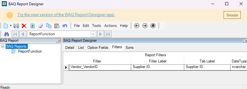

But still getting the same report with all Vendors. Was attempting to follow @kve ‘s code example here but it looks like this might be different as this is a modification within BAQRptFilter instead of BAQRptOptionFld?
Tried modifying FilterField to different values as well (“Vendor_VendorID”, “VendorID”, etc) alongside FilterValue , still no luck. What am I missing here?
I think FilterField might be your issue. It looks like you need to indicate that the VendorNum is the filter field:
This report uses VendorID for the filter:
Tried the following XML tags with no luck:
<FilterField>VendorID</FilterField>
<FilterField>Vendor_VendorID</FilterField>
<FilterField>Supplier ID</FilterField>
Copilot even convinced me to try adding VendorID as a parameter to the BAQ and adding
<BAQRptParameter>
  <ParameterID>VendorID</ParameterID>
  <ParameterValue>{vendorID}</ParameterValue>
</BAQRptParameter>

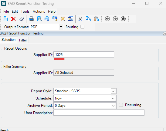

between the <NewDataSet> tags, still no luck. Guess I could use VendorID as an “Option Field” and go the route you did, but still feel like there’s something small I’m missing to get the Filters to work instead
Well, doesn’t seem like I can get Option Fields to work either! Added an Option for VendorID on the BAQ Report which works fine:
Used xmlString = xmlString.Replace(“<FieldValue />”, $“<FieldValue>{vendorID}</FieldValue”); to set that value in my function.
Full XML after the report is generated, which shows all inactive vendors instead of only 1325 as expected (**Removed the changes within the BAQRptFilter tag to test Option Fields alone):

So strange..

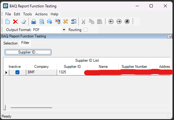

Solved! Thanks to @subodh.raikar ‘s comment on this original thread..
I was converting the DynamicReportDataset output to System.Data.DataSet using Ice.DatasetAdapter.ConvertToGenericDataset() and then using the WriteXml() method to get the xml for the ‘Filter1’ field. Because of that, the root element I got was ‘NewDataSet’.
Added to my function:
// Change root XML element from <NewDataSet> back to <DynamicReportDataSet>
    xmlString = xmlString.Replace("<NewDataSet>", "<DynamicReportDataSet xmlns=\"http://www.epicor.com/Ice/300/BO/DynamicReport/DynamicReport\">");
    xmlString = xmlString.Replace("</NewDataSet>", "</DynamicReportDataSet>");
    // Set the Filter Field name and Value
    xmlString = xmlString.Replace("<FilterField />", $"<FilterField>Vendor_VendorID</FilterField>");
    xmlString = xmlString.Replace("<FieldValue />", $"<FieldValue>{vendorID}</FieldValue>");
Now able to filter using both “Option Field” and “Filter” BAQ Report fields. Thank y’all for the help :saluting_face:
