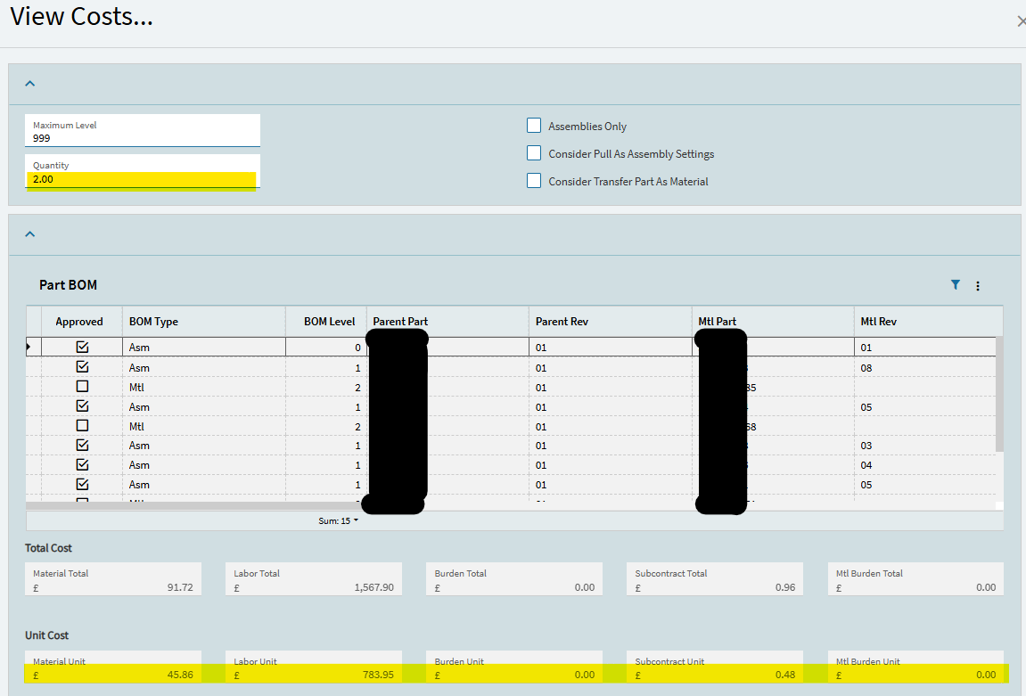

For example, I have a part where the Method Tracker > BOM Costs screen shows a unit cost of £1,219 for a quantity of 1. If I change the quantity to 2, the cost per unit drops to £869 , due to setup costs on BOM parts being spread over more units.

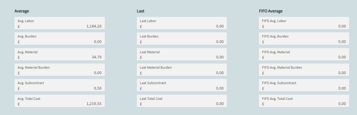

It seems the Quote Engineering screen is just using the value from Part > Cost (per below) - instead of calculating/rolling up the BOM costs, from the Part’s Method, using the batch qty required on the Quote.
Part > Costs
Method Tracker > BOM Costs - ‘Quantity’ set to “2”

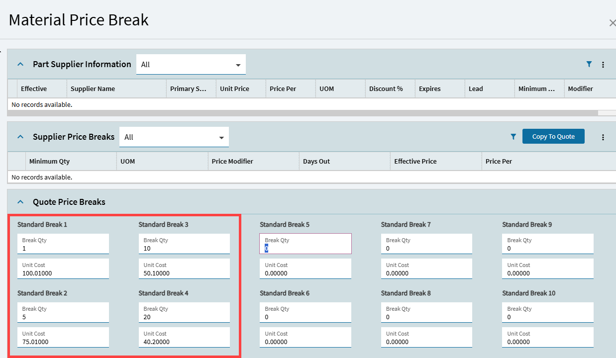

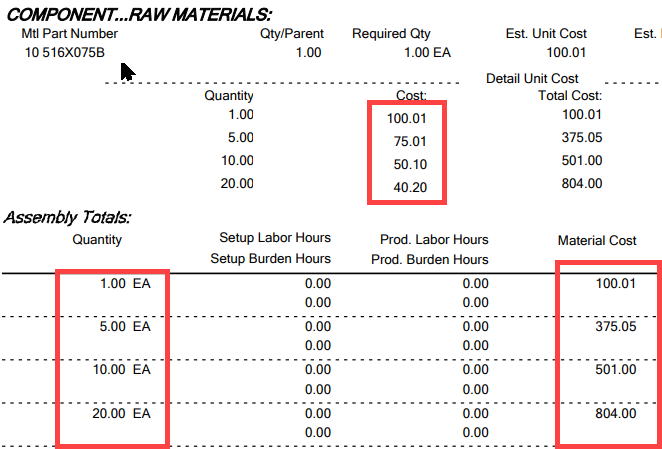

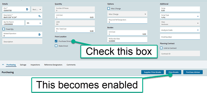

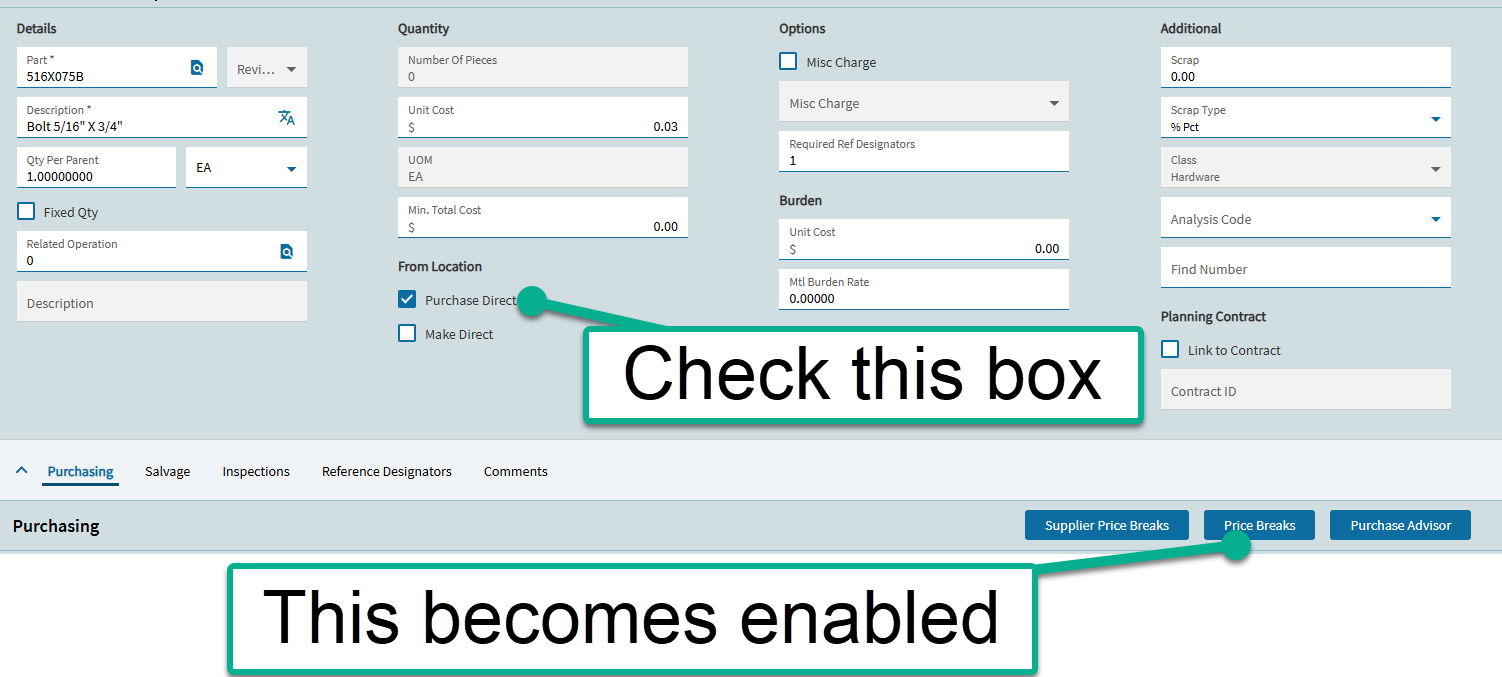

You are able to price (Cost) breaks in materials even if they are not purchased.
First step - enable the capability at the material level
Enter in your break quantity and costs.
