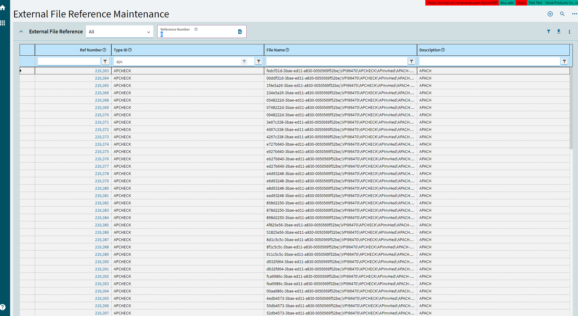

Can I mass delete document type files?
I want to delete all files under type id “APCheck”, I have to delete each one and there are thousands of those file. How can I delete all?

Those are in ECM, so I think removing the Xref will only take the reference out of Epicor, but not remove the file from ECM. I think it would be similar to what @kve posted, but using the AttachmentSvc or maybe you have to do both.
Run a trace on the screen and see what it’s calling.
I would imagine that screen does both, so you could just mimic that.
If you delete using DMT, it should delete them from ECM. If you do it via the UI it does delete from ECM.
Yeah I should have thought of that. It will probably leave all the XFileAttach records intact, but with orphaned XFileRefNums
