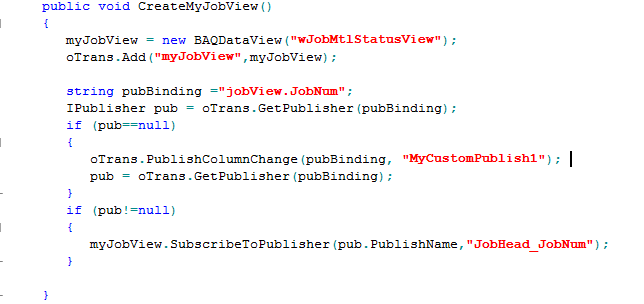

I create a BAQ call wJobMtlStatusView and add a view - myJobView in the Job Status Maintenance with the codes at below. I set the gridlist binding view =myJobView. It works but only can display on Job in the grid. How can i make all the job searched can be showed instead of only one?
If you want all jobs, then don’t use the published binding. Just stop after oTrans.Add(…
If needed, you may need to perform a myJobView.OnSearch("","",true);
for the final line here.
That will be more complicated. Short answer is yes, but you will need to filter the results by what is in the search. Some of it can be added in the OnSearch, but you may have to use a RowFilter too.
