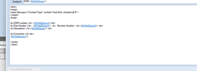

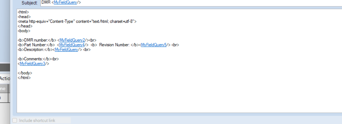

this worked out for me:
DMR number:
Part Number: Revision Number:
Description:
Comments:
