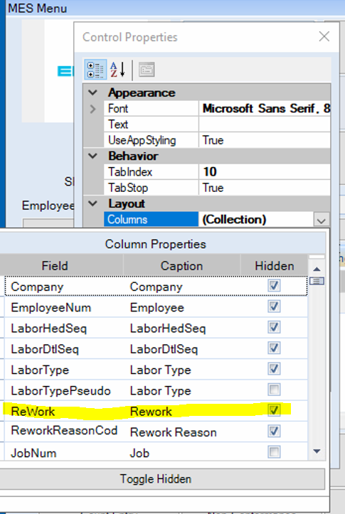

Can MES "Production" tab results be modified to show more fields?
Is there a way to modify the results on the MES client “Production” tab to add more fields? We would like to add the “rework” flag to the results list to show the operator that they are clocked into rework. Is this possible.

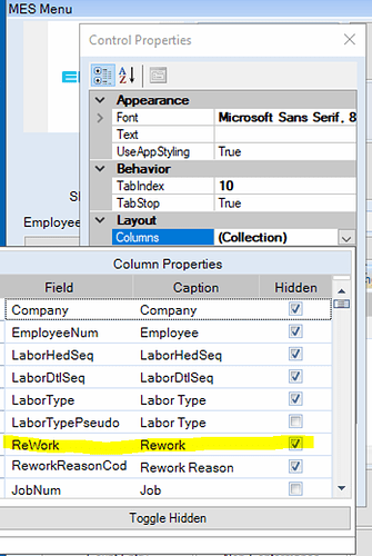

@emanpittfan I think this should be simple. I was going to do a post processing bpm and hijack an existing field, but I saw rework in the dataset of the trace, so I looked at the grid and Rework is there but hidden in my version. Assuming it has been in the grid all along you should be able to expose it your mes customization.
